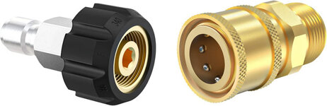

I converted my Sun Joe to use an industry standard pressure washer hose and wand. The pressure washer fitting on my Sun Joe is a male threaded M22, which allows me to attach a standard pressure washer hose. All you need to do the conversion is a standard pressure washer hose and standard wand. I hate screwing hoses and nozzles together so mine have quick connects with male plugs and female couplers. The most common quick connect kits come with female M22 threaded plugs and male M22 threaded couplers.
The standard hoses have female M22 ends so you use the male threaded couplers on the right. The machine and wands have male threads so you use the plugs on the left. I have a couple of 25-foot hoses as well as a 50-foot extension hose with an M22 male plug on one end of the hose. It's the reverse setup, which is less common but still available.

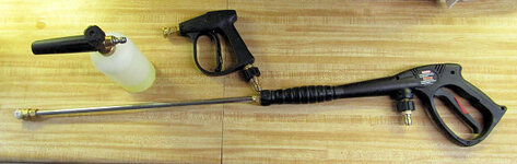

For patio cleaning I recommend the long wand but for a foam cannon I recommend the stubby wand. Something about swinging a quart bottle of soap at the end of a long wand (with one hand) disturbs me.
The ends of these wands have smaller 1/4-inch quick connects that take all kinds of nozzles, including the turbo Kay mentioned.

You can avoid the whole quick connect trouble and expense with nothing more than an M22 male/male ****** for that extension hose.

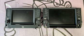

GTI 8" MIB2 Display Upgrade... sort of
A few posts back, I mentioned upgrading the infotainment display in my GTI from the stock U.S. 6" screen to the European 8" screen. It's a straight swap, except you need a new surrounding trim piece, which also includes the center HVAC vents.
After waiting a few weeks, I got the screen delivered from Latvia, and the trim part delivered from Lithuania. Fun fact, my brother's wife is Lithuanian. Anyways.
After reviewing some YouTube's, I dove in.
Pop the airbag warning light / hazards switch:
Unplug the connnectors:
Took me a minute to figure out how to get the top one off. It's amazing how many different harnesses and plugs VW uses... I swear every one is different.
Then carefully pry the trim surround off:
It's not my first rodeo with VW trim pieces, and I won't lie I've broken my fair share of clips. But I managed this one without issues.
The vents are clipped to the trim, but need to be pulled out together or they may break.
Below you can see how many freakin' clips there were:
Then the radio comes out with radio removal keys, 4x of them. I knew I had some and after 45min of looking, I found them. Well, 3 of them. :mad: Of course the 4th was missing. I was almost about to order some on Amazon for next-day-delivery, but then had the bright idea to check Thingiverse. I'm sure you can tell where this is headed...
A bit flimsy, but it did the job, and only took 15 minutes to print!
Next was just a matter of releasing the two cables on the old unit, and swapping in the new unit. Below you can see the size difference in the display:
For some reason the European radio connector doesn't use one of the "nibs" on the U.S. connector. Otherwise it's identical. The solution is to just shave it off with a razor blade:
(credit for the connector pics to @cky3396 that I pulled from this Vortex how-to)
Before buttoning everything back up, I turned the ignition on to make sure it works.
$@#! :mad:
Half the screen pixels are wonkydoodles. Colors not represented correctly. Fuzzy text. Flickering.
I cycled the ignition a few times, unplugged, cleaned, and re-plugged the connectors. Even took a short drive to clear any codes. Same result.
Obviously I can't live with it like this, so I contacted the eBay seller, and as soon as they authorize an RMA request it's going back to Latvia.
As for the screen itself, I have mixed feelings. The size looks good. But the display is the same resolution as the 6" one the car came with, so every UI element is much larger, and I can notice it's softer/fuzzier. Granted it was a bit hard to judge with half the screen messed up. And I knew this fact going in. But experiencing first hand, I do wish there was more resolution to accommodate the larger size.
It's not wrong, since this was the highest OEM configuration in Europe. But I'm just used to it smaller. I'm sure I would get used to it in time.
What I will say, is Google Maps on Carplay looks great at the bigger size, and probably the biggest revelation was the back up cam. Man does that look good and you can actually see it now.
I don't mean to be a complainer, but I don't really enjoy doing semi-tedious mods like this 3x for no reason. Still have a bad taste in my mouth from the Aerofabb spoiler.
I was considering just keeping the 6", but I special ordered the 8" trim piece (and it wasn't cheap). So, I'll probably see the return through, and hopefully source another display for a reasonable amount.
