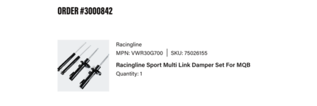

Got the shocks ordered! Now need to source the mounts / bushings / bolts from FCPEuro.

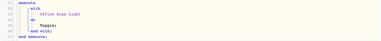

So my solution was to write a simple "toggle" action in WebCoRE:
WebCoRE pistons (automations) have an external URL end point that will execute the automation when loaded. With no triggers in the script, this will simply do whatever is in the automation — in this case toggle the Philips Hue bulb state.
Since I'm activating it from my computer anyways, it's easy to load the piston URL from a simple bookmark:
The one downside is it will either reload the page I'm on, or I have to open it in a new tab and then close that tab. But other than that it's pretty slick.
I know you can save Javascript to a bookmark, and Javascript can call a GET URL command that I presume would run in the background. This would make it really seamless, as then the bookmark would act like a true "button" for the light, but unfortunately I don't know Javascript.
If anyone on here knows how, let me know!

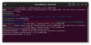

Next was install a free app called "Balena Etcher" onto Ubuntu, which will allow me to overwrite the internal hard drive with the Home Assistant OS.
Installing Balena Etcher to Ubuntu required some Googling. And some shell commands.
I had to fix some dependencies which fortunately there were some commands available on the GitHub page for Balena Etcher to do that. Because I barely know what I'm doing. I used to run a hobby linux home server about 10 years ago, so I know some basics, but as with all things that require muscle memory I've forgotten 90% of it.
Miraculously, though, I figured it out and was able to write over the internal hard drive with Home Assistant.

iMac Bias Light
Remember the Philips Hue / 3d printed "bias light" for my work computer a few posts back? That I was controlling with a Chrome bookmark (URL request)?
Well, not anymore! Home Assistant has a native MacOS app, that pulls in the computer as a "Device" and many "Entities". These entities are essentially sensors or parameters about the computer that can be used as triggers or conditions in automations. The list is quite extensive:
- whether or not the computer is active (clicking, scrolling, typing, etc)
- whether or the audio inputs or outputs are active (playing music?), can detect which is selected and if it's "in use" or not
- whether or not the built-in web cam is active
- current WiFi SSID
- connection type (wireless or wired)
- which display is primary / active, and it's name
- frontmost App name (i.e. Chrome)
- last software update
- storage (free space on boot drive)
This is pretty incredible. So I've used the "computer active" entity to automate the bias light. As soon as I move the mouse, wake the computer, login, press a key, etc, it's considered "active". So literally when I begin using my computer, the light comes on automatically, and immediately.
And then I use the opposite to turn it off (becoming "inactive"). I don't know the time, but it's after a certain amount of inactivity. The default has worked fine for me. If I walk out of the room for 15min, the bias light turns itself off. Completely automatic, no intervention on my part. Freakin' cool. This type of automation honestly feels magical.
