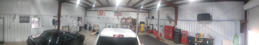

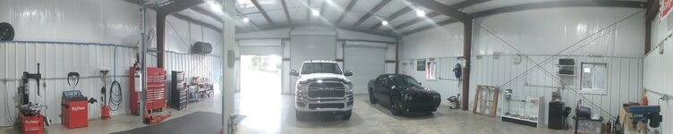

Building looks great! You did a lot of work in a short amount of time especially with all that traveling, you should be very proud. It took me twice as long to do similar work when we built our 45x55x14 5 years ago. Your shop looks way bigger than ours for some reason. Below is a few pics of my sanctuary. Keep us posted on your progress. Can't wait to see how you finish the inside!
IMG_20210119_121534272[1].jpgIMG_20210119_121643993_HDR[1].jpgIMG_20211020_164354378[1].jpgIMG_20211020_163906923[1].jpg
