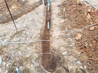

After pouring the concrete for the meter rack I called the power company about the next step. Sounds like they just need the rack and meter base installed to come inspect. Then maybe they plan/ schedule the new transformer and wire run to the rack?
Assuming they will be fairly quick I dug down at the pole to find the existing house feeder wiring. I started digging at the right where I figured the wires weren't and slowly scraped the dirt into the hole until I found the wiring. It wasn't 18" down, maybe it was when installed. The hole filled quickly with water and by Monday it was ice.
Having been under the house I saw the wires pop out over near this window. So I figured the run was this way. The wiring at the pole also went that way.
I chose a spot that would be tangent to the existing run and go straight to the new sub panel. This new part of the run will be in conduit but I am not sure what the NEC says about existing wiring. Can the existing wiring be left at 18" and only the new part of the run put in conduit? Does the whole run need to be in conduit because its been messed with?
Dug down where I thought the wires were and found them on the assumed line. These ones were 18 inches down so I figured there may have been erosion at the pole.

I was waiting for the 2-1/2 meter offset connecting the meter base on the left and the first subpanel in the center. I was also waiting for the POCO guy to call and schedule inspecting the rack, but he showed up I was installing the meter offset. He said I was supposed to have the meter base to panels wired for his inspection but that he could see I was doing good work and would push the paperwork through. Should be out here to connect the meter in 6 weeks or so!
I braved the risk of getting the backhoe stuck again OR having it slide into the trench, backed it up over the existing trench and dug out to connect the meter rack trench. broke the surface off where the ground was still frozen about 4 inches thick!
This trench has been open for 2 1/2 months and filled with water quickly so the pipes had floated up. All that water soaked into the clay and mud which flowed under the pipes. Luckily it was not frozen mud because the ice and water were insulating it. Now I got the fun task of shoveling mud out from under the pipes!
Taking some measurements for cutting the conduit. That 3 on the right should have been a 7 lol
Pulled the wires back into the shop by about one foot to fix a mistake I made in there trying to keep the breaker at the top which may change! Then measuring the "extra" at the meter rack end it seems like I will have enough to use 250kcmil cable to go from the meter base to the shop subpanel. Then likely 4/0 for the house input. Despite all the measuring I measured from the wrong side of the 3" - 2-1/2 adapter and cut the pipe 4" too long and had to glue that 4" section back in. You can see the two couplers right next to each other at the ground under the meter. would have been perfect if I had not messed up lol. Luckily I bought extra couplers knowing I was going to be the one cutting the pipe! Also put too much primer on so it is visible coming out of the bottom fitting.
I have not decided what to do with the 3/0 that would be neutral for a 3 phase run but will be my ground so it is just coiled up in there.
The next step is to get the ethernet and fiber lines pulled back out of the attic, out of the conduit and run the conduit over to two locations. Likely One pipe will pop up to the inside of the future garage and another popup in the center of the rack area for possible power upgrades? Maybe just popup in the future garage... I will likely have to make changes here in the future especially if I am moving the water treatment and stuff into this future space. The internet stuff needs to be dealt with because the rain is coming in a few days so I want to fill this trench back in some to keep the pipes down! will need to deal with the pex as well!
