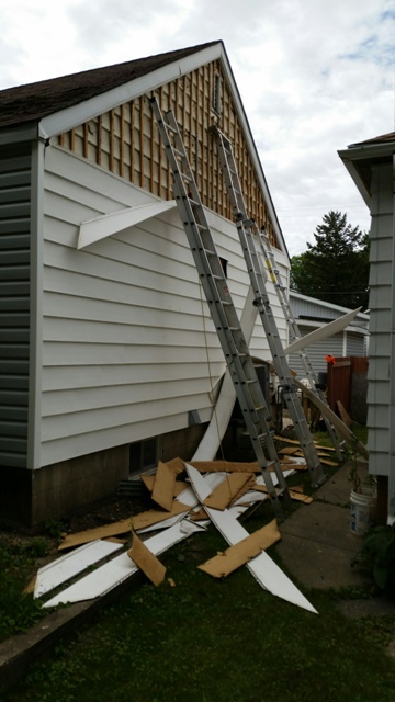

Damn strapping...
Oops, neighbor's window took some shrapnel, good thing they are out of town!!

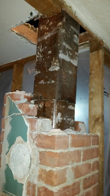

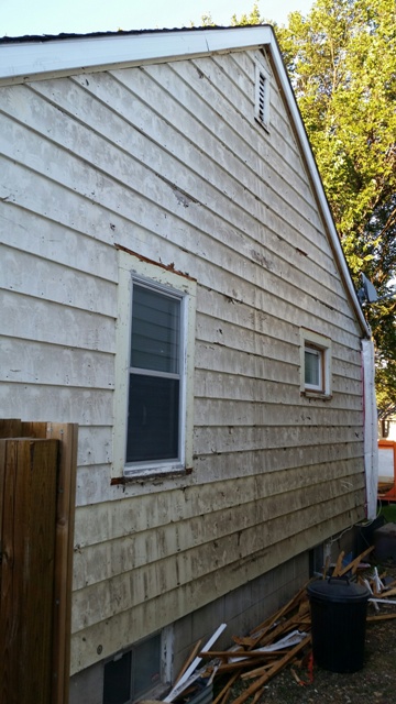

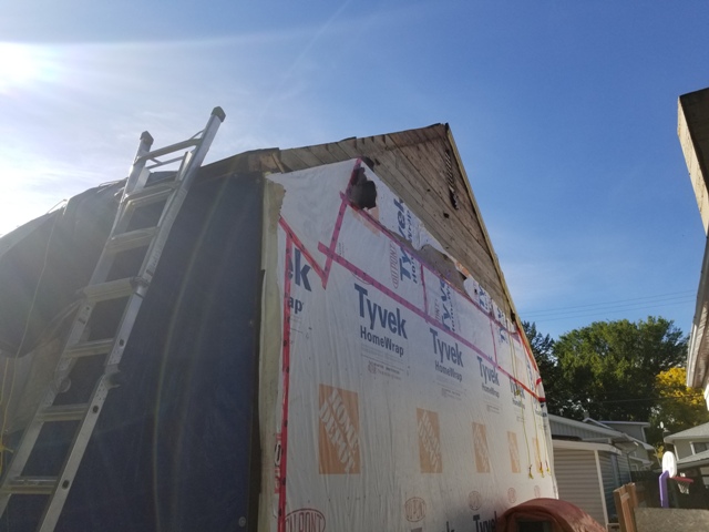

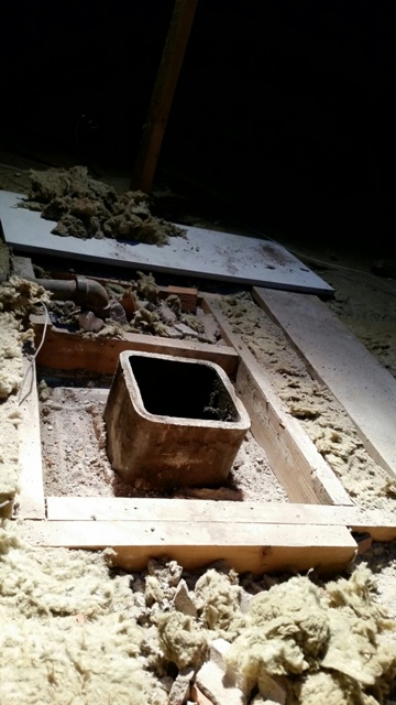

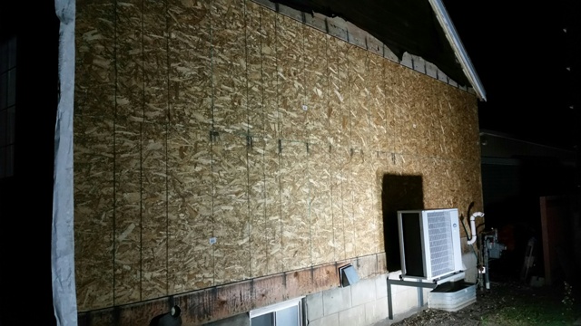

Today's project is to strip the rest of this wall, then I only have the front to do!! Next project is going to be ugly, chimney removal...

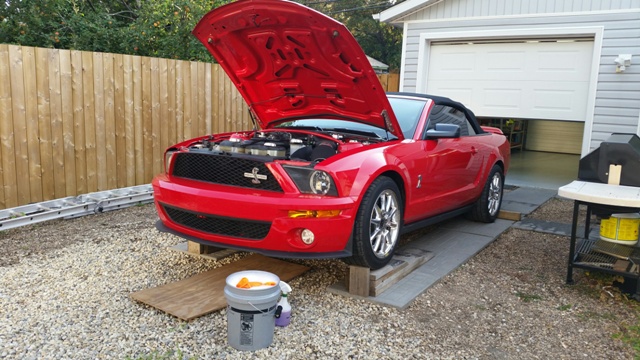

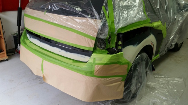

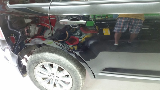

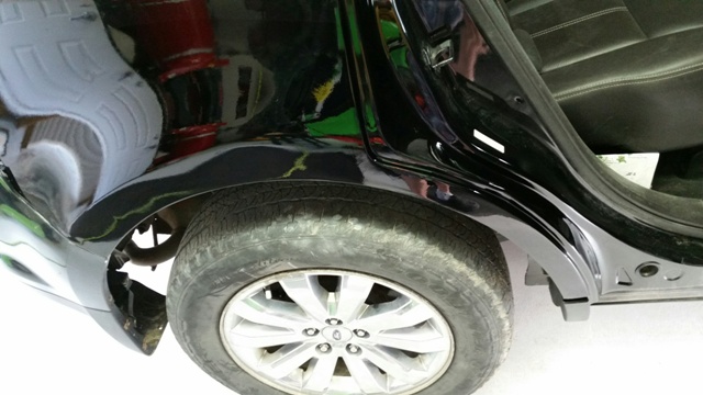

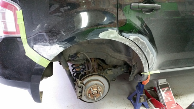

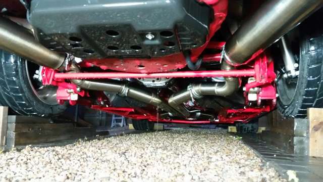

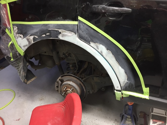

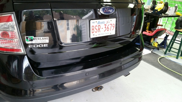

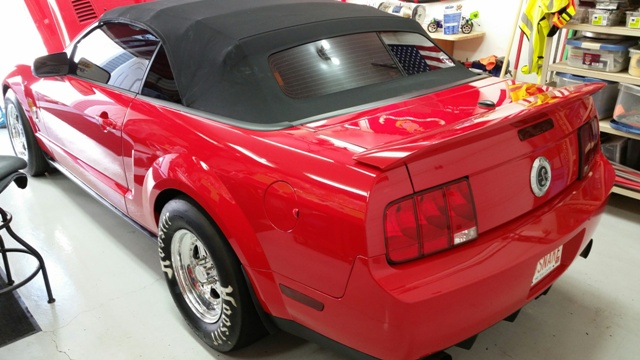

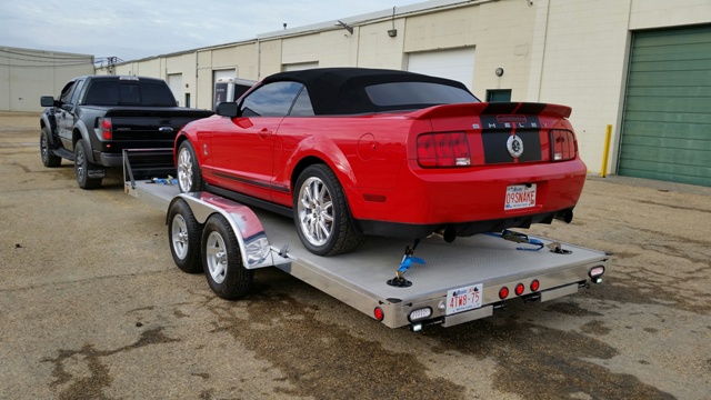

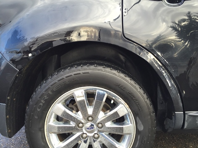

Did some body repair on a buddies Edge this weekend...
Turned out pretty good for a hundred dollar repair using spray bombs and no booth!! Lol...
First time that I blended new paint with existing,

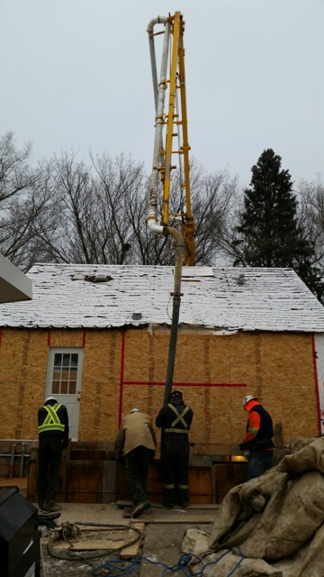

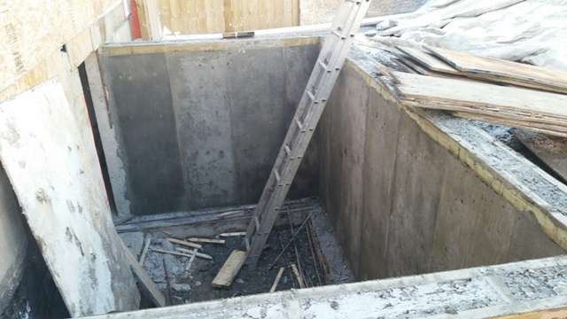

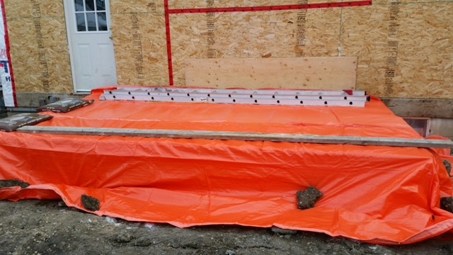

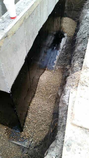

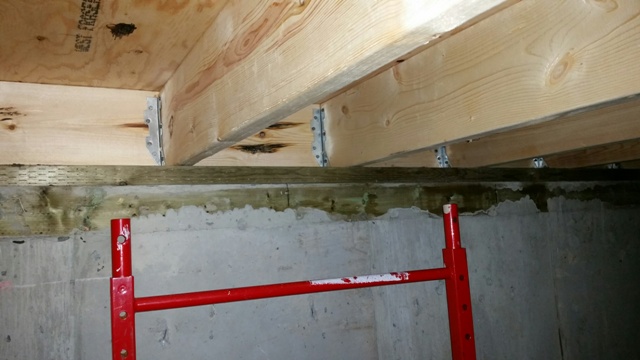

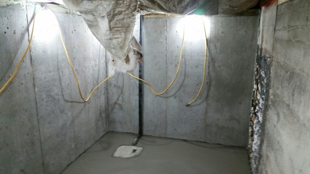

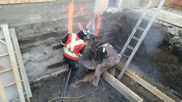

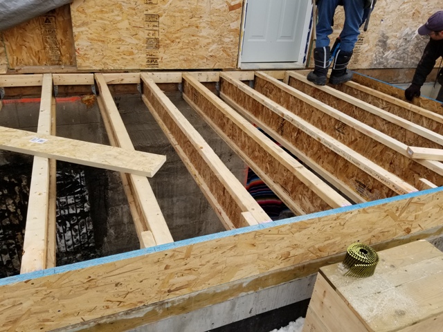

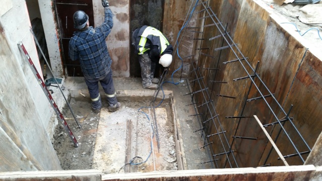

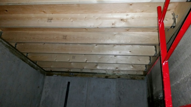

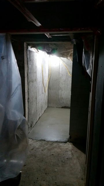

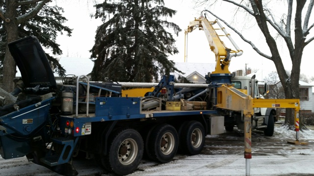

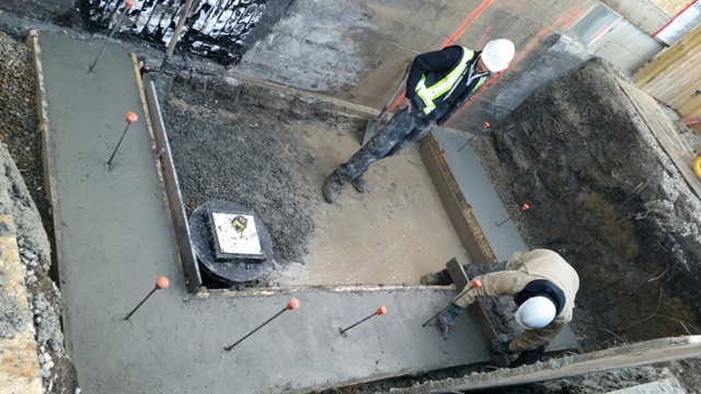

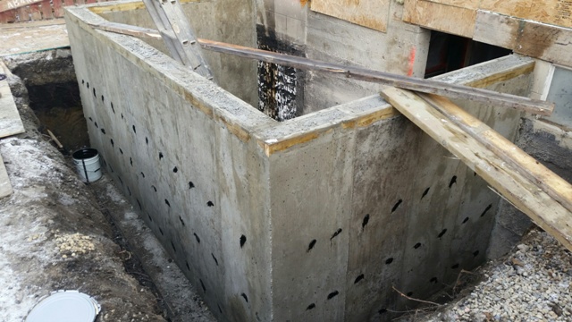

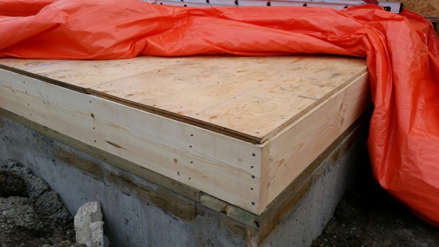

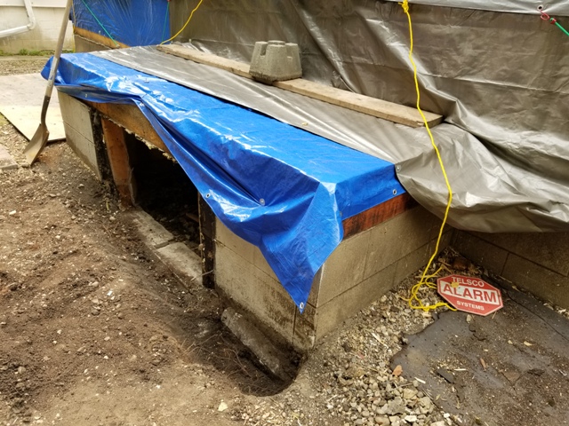

My new 8' x 14' basement storage room, and foundation for the 2 story addition!! I was going to put the addition on piles, but decided to go with concrete...
My Dad helped me build the sill plate and floor over the foundation, and by helped I mean he took over the project!! Lol!!
We didn't need to put hangers on the sill side, but we still did...
Ready to build on!!

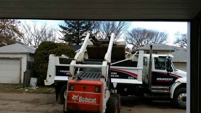

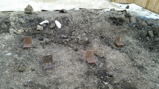

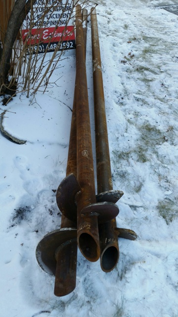

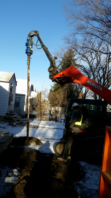

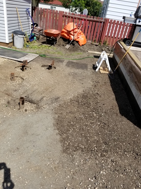

I had some piles drilled in for my front and rear decks and steps,
4 in the back,
5 in the front,
The decks and steps will be very solid!!

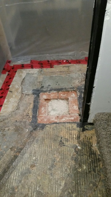

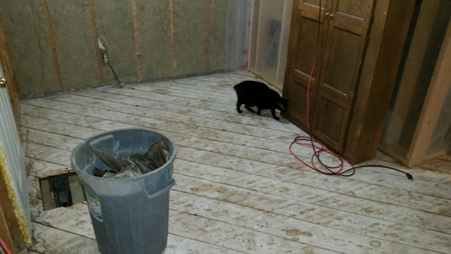

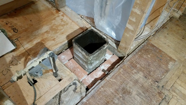

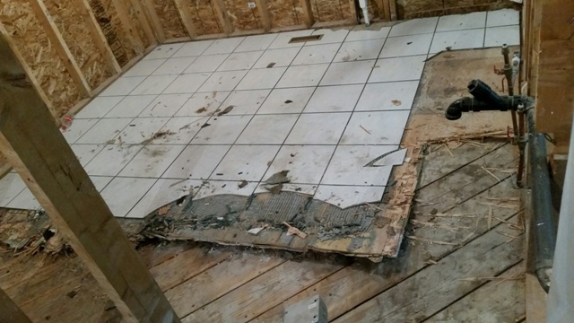

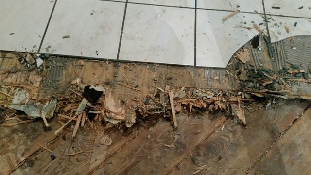

Removing this mess right now, I am about 3/4's finished... It's killing my back...
2 layers of sub floor and a million nails and staples!! I put the top sub floor down years ago, and went nuts with the staple gun... Lol...

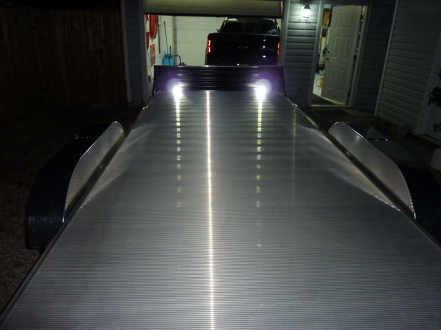

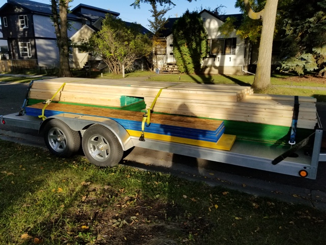

It's a 2013 Charmac 18' x 7'... GVWR is 7000 lbs, and the trailer weighs about 1285 lbs...
This is what it looked like when I bought it!!

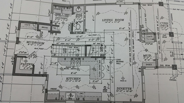

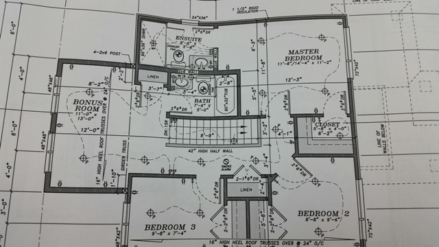

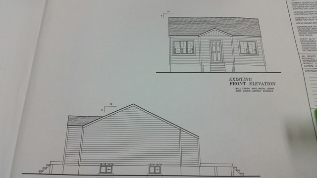

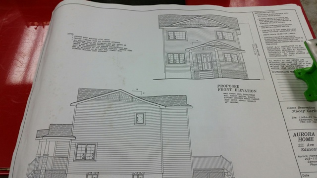

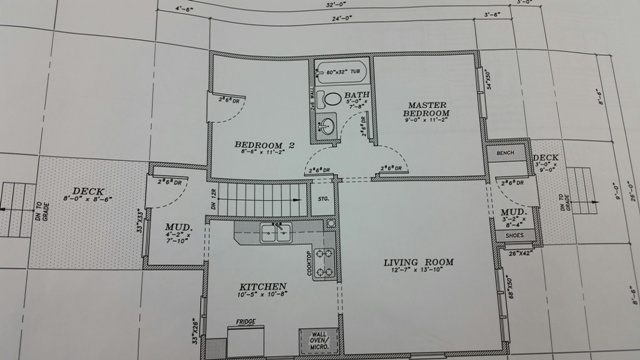

Can you post a scan of the plan for the addition or at least a sketch? Not clear (at least to me!) from all the snapshots where you're heading.
O
OCD
Dec 30, 2014
1,316
Edmonton, Ab. Canada
Here's what I have going on... Current layout,
Rear addition and second story,
New main floor plan,
New second floor plan,
The main floor mudroom and second story bonus room will sit on the footing and walls we just poured!!

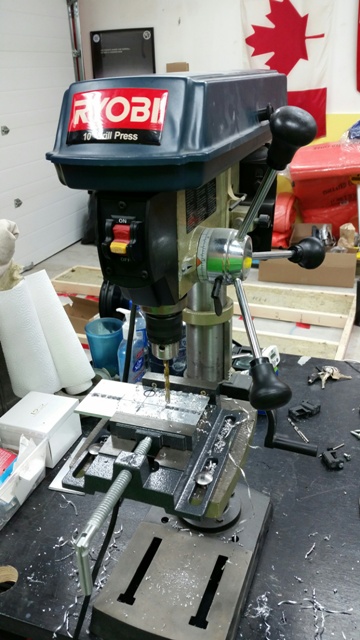

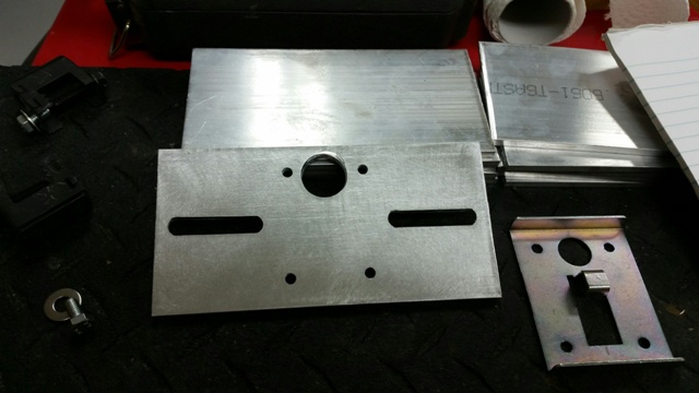

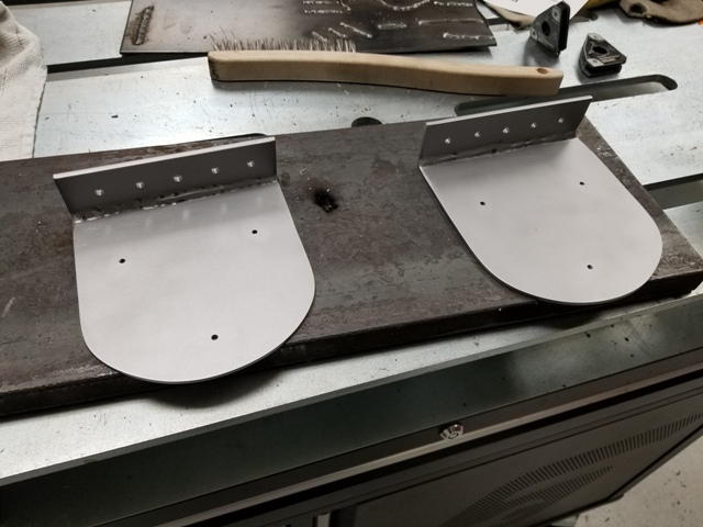

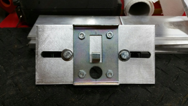

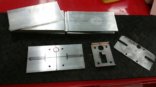

We are installing a paging system in a new car dealership, and need to hang some pendulum speakers from open steel beams... We use beam clamps, but the speaker brackets are too narrow for them, so I had to make a mounting bracket...
This is what I came up with, the speaker bracket is in the middle, the one on the right is the prototype I whipped up with some metal I had laying around... I went and got the aluminum today!!
My mill, LOL!!
The slots are not perfect, but I have 7 more to make so they will get better!! They will be 30 feet in the air anyway!!

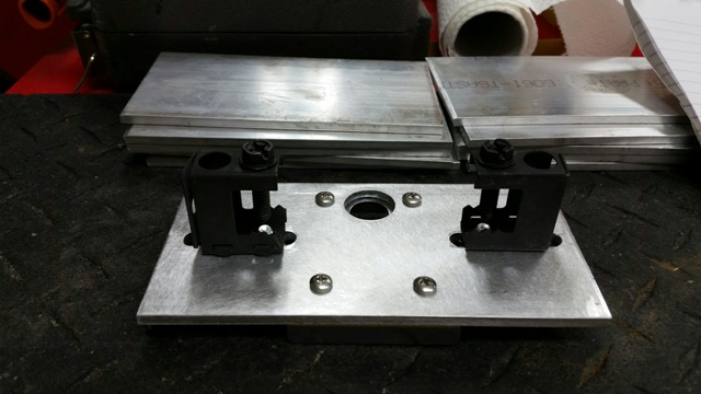

The clamps go on each side of the beam,
The speaker hangs off the bottom of the bracket!!
I see a small mill/drill in my future!! Plus a mig welder and plasma cutter...

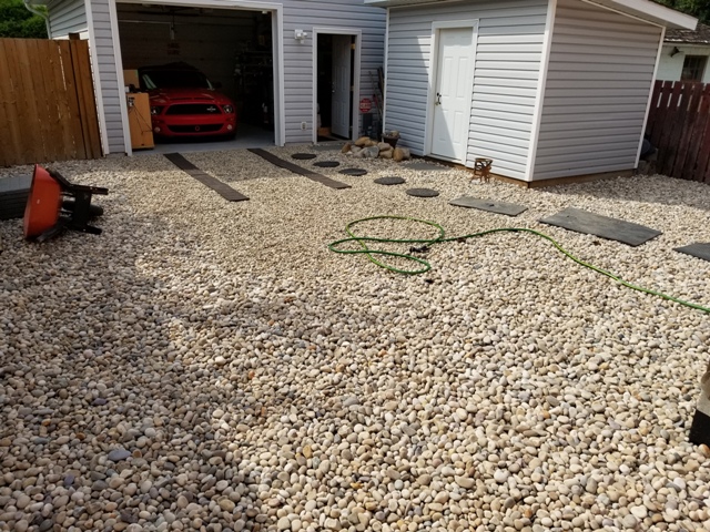

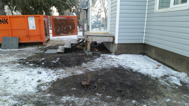

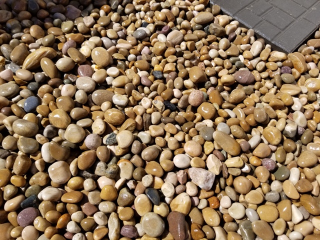

Still going on my reno!! Lol...

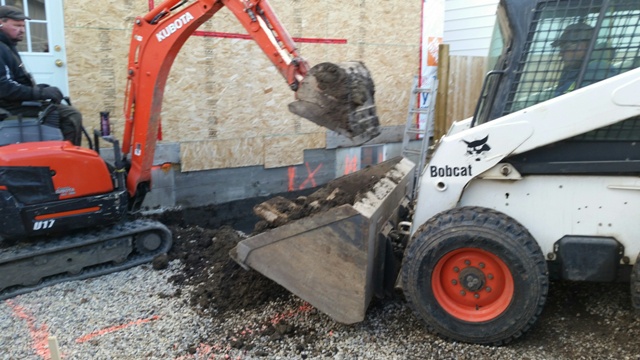

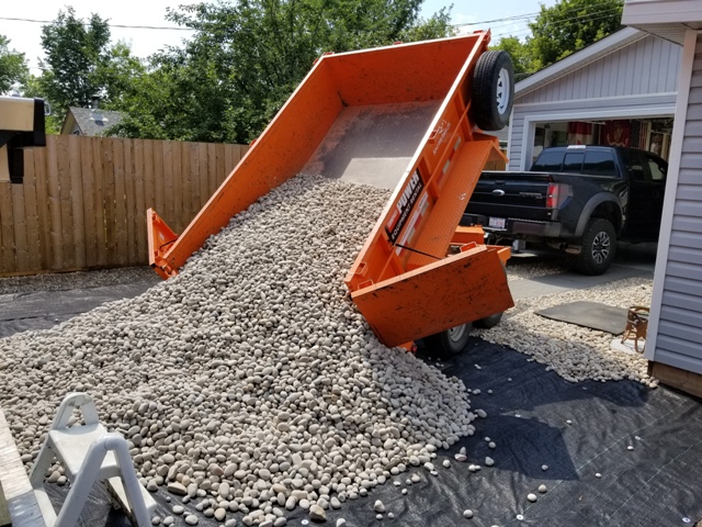

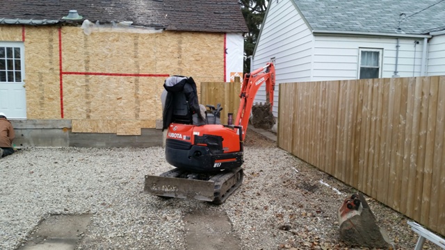

After the rear addition last winter, the back yard was a mess,
I put some fabric mat down, and covered it with creek stones for now...

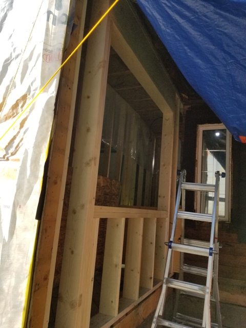

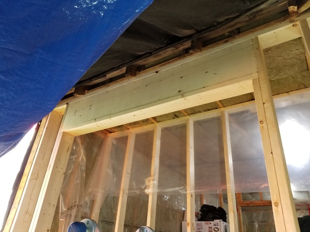

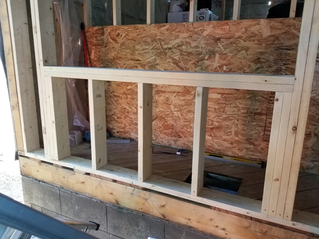

Same with this side,
New wall section framed in,
2x12 double header,
The weight of the second floor will be sitting on these walls, so I over built them a bit...
The jack studs run right from the header to the floor so they won't put any pressure on the bottom sill... Should help stop any future warping...
I have used screws on everything in case I have to make any changes!!

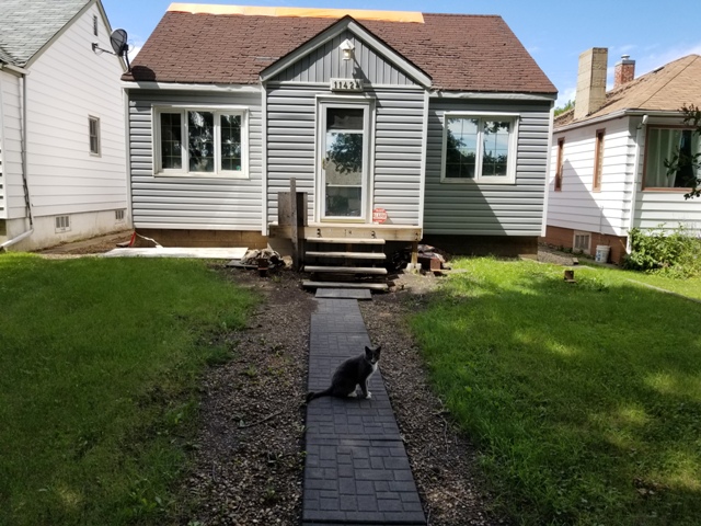

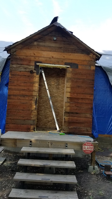

Next the front porch came off, it's getting totally rebuilt...
My neighbors have been really good about all the mess, dumpster on my front lawn all summer, and the noise!! I try to be as respectful to them as I can...

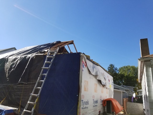

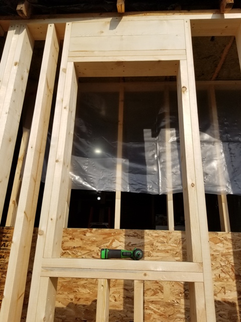

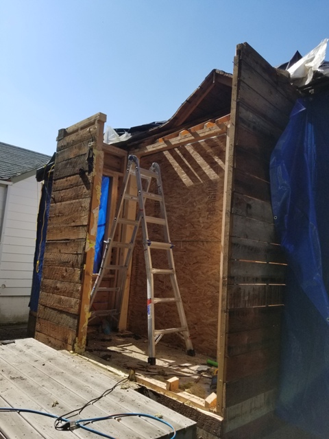

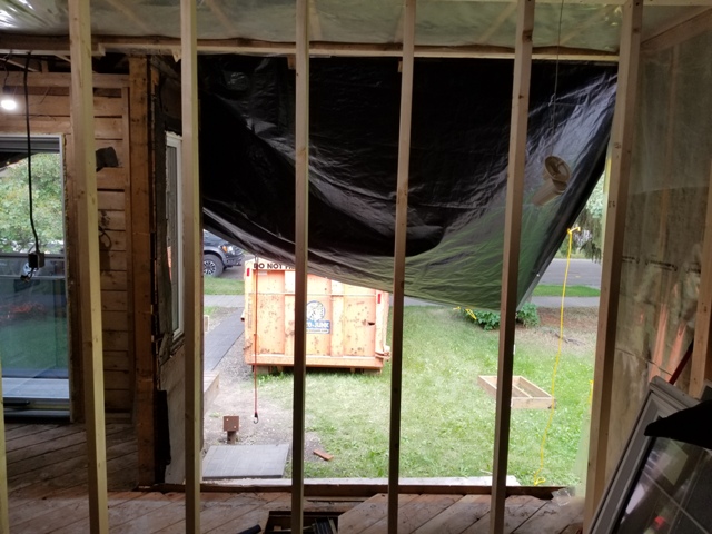

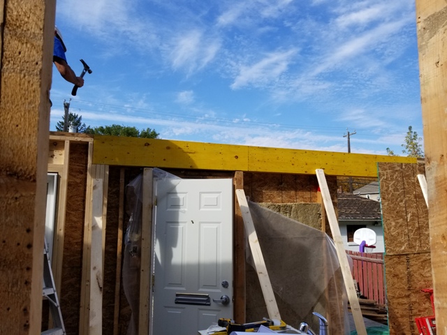

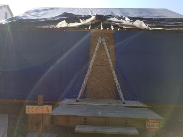

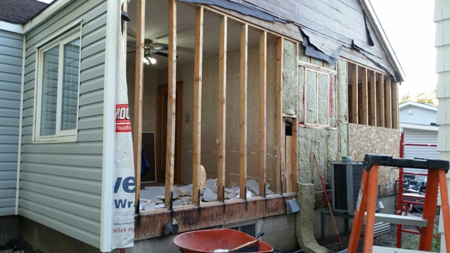

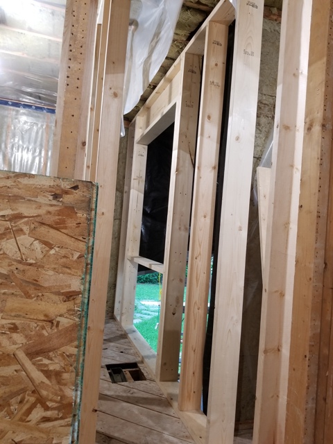

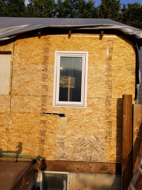

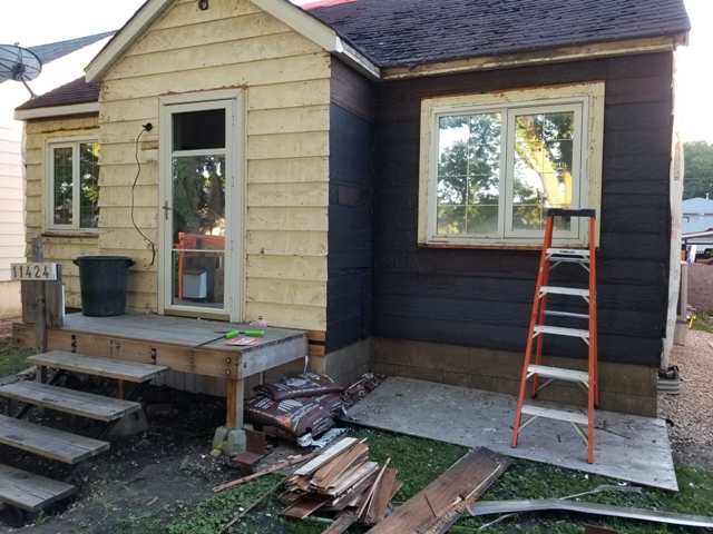

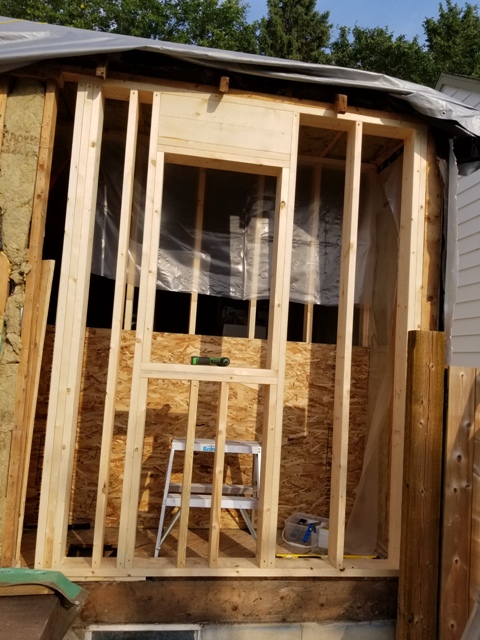

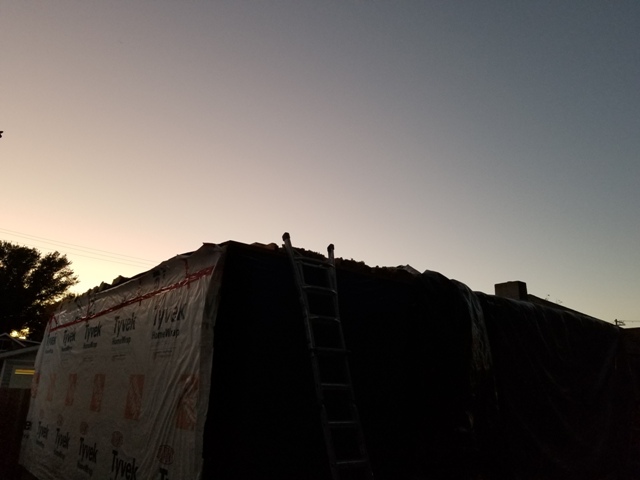

The front porch will be rebuilt when the second floor goes on... My Uncle and Cousin are super pro framers, and are coming to head that up!! #Whew!! I am getting the prep done for that...

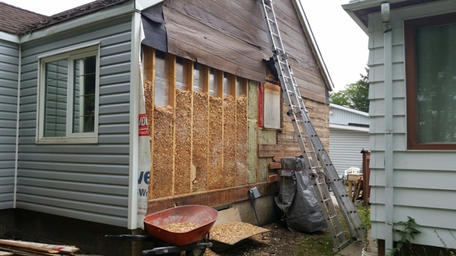

Last to sections I have to replace are the back walls, that's where I am at right now...
Smaller windows so I built it the standard way... The 6 foot 2x12 I had left over from the front had bowed so fast that I just went with a 2x10 double header and dual top sills to get the window close to the same start height as the front!!
That 14.4 screw gun is my favorite tool... Well second favorite... Lol!!
I put the old sheeting back up for now and temporarily installed the window so my cat has some sunlight!!
The window isn't perfectly aligned, but there will be about a 3/8 gap around them... Another "Whew"...
Just have the last rear section to replace before the roof comes off...

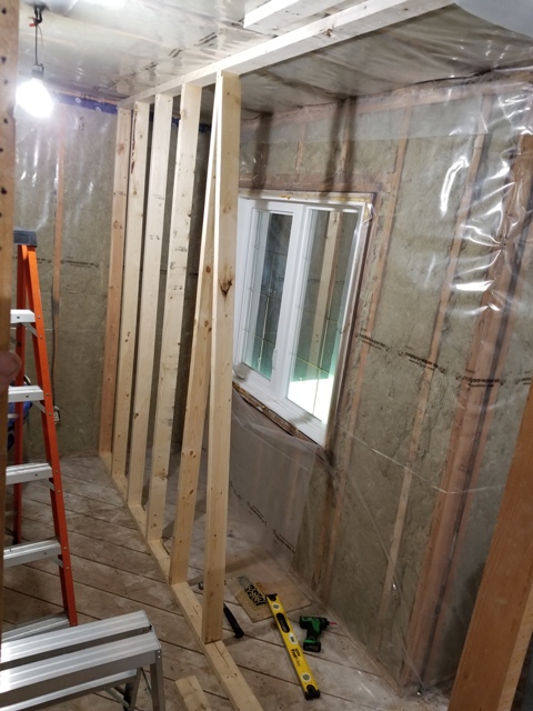

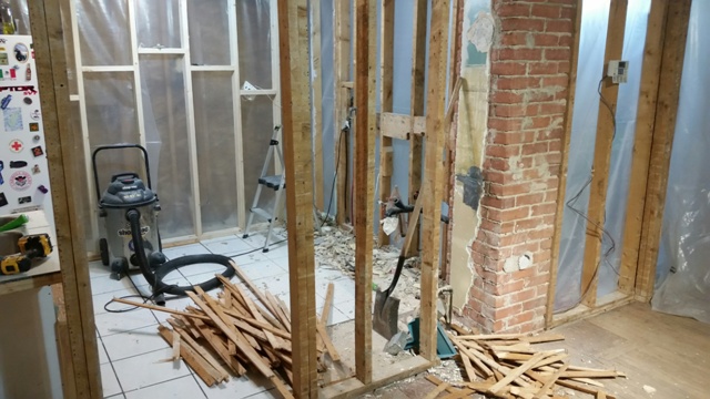

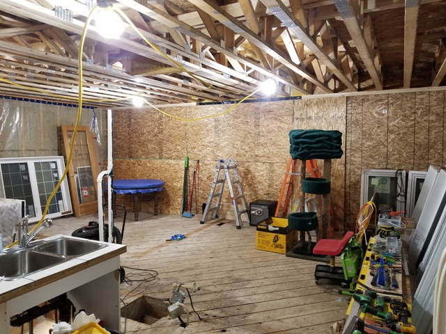

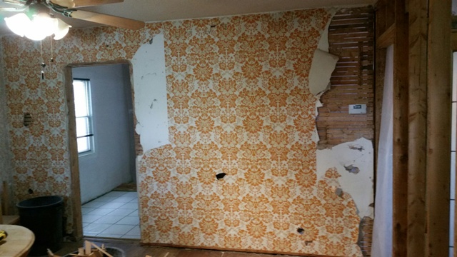

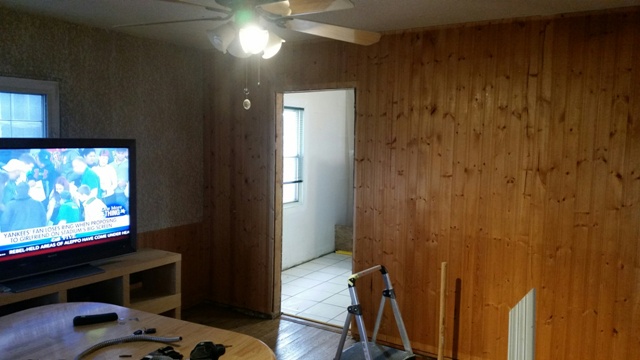

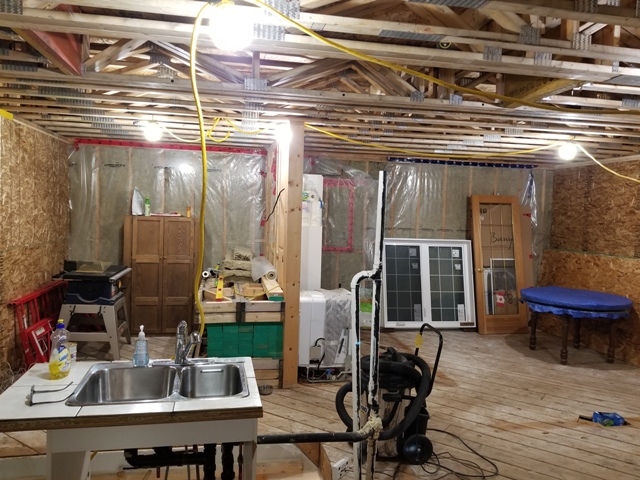

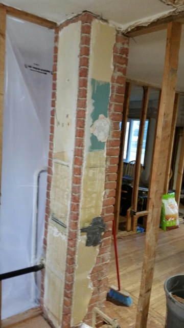

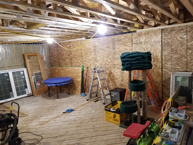

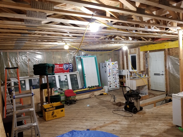

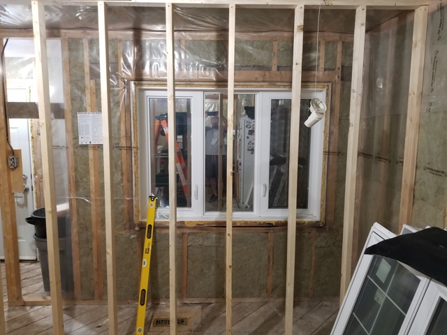

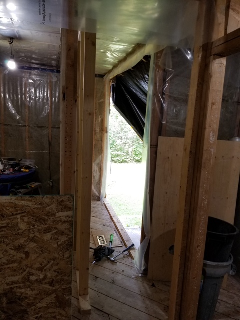

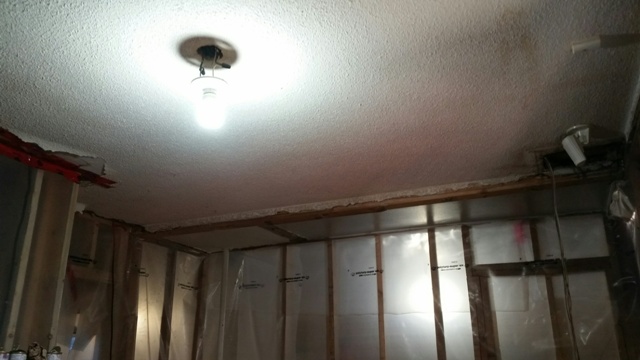

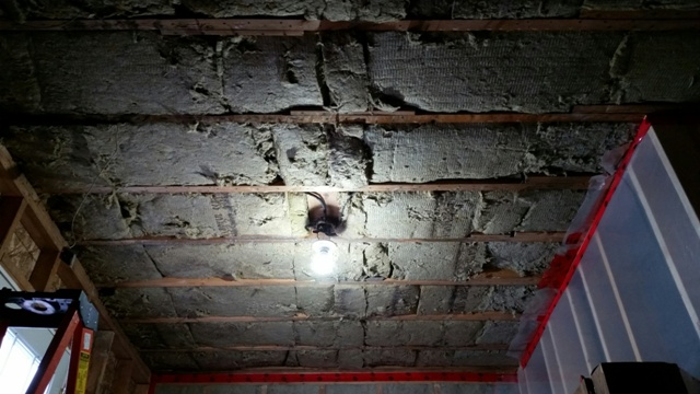

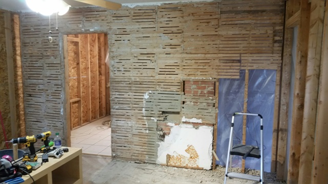

Got the rest of the old interior walls out, and a bit of a clean up done...
This area will be all open, living and dining room,
The 2x6 wall in the next pic stays, there will be a wall added to it that goes left, that is where the bathroom and laundry room is... There will also be a wall that goes behind the sink, up to the pipe... That's it on the main floor!!

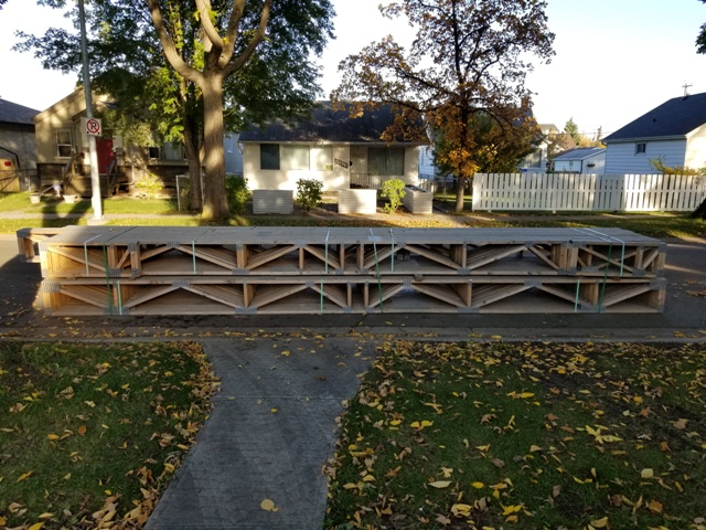

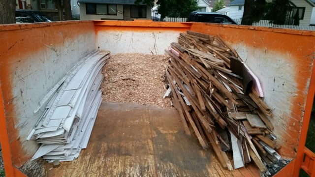

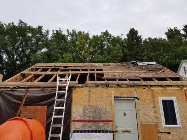

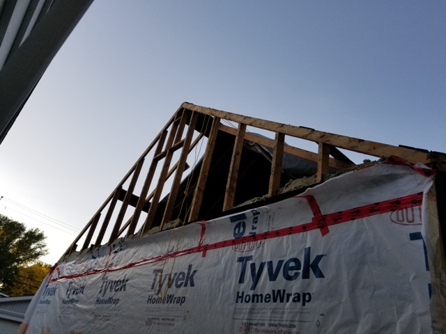

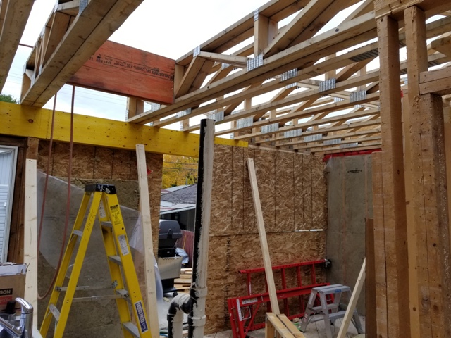

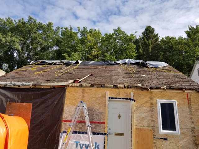

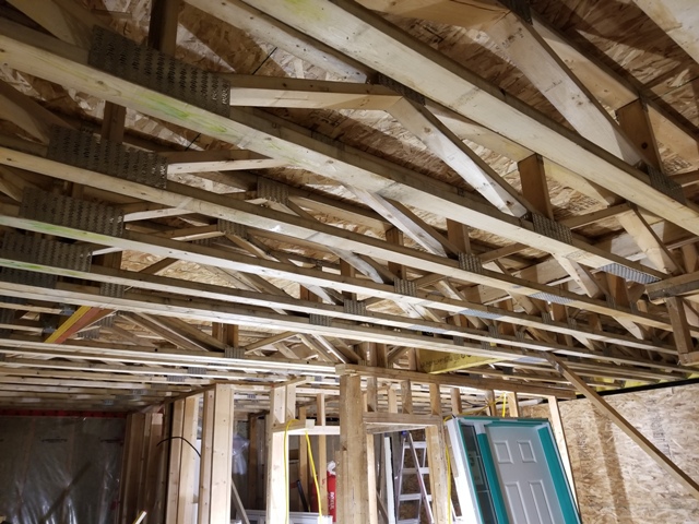

All I had to do to build up was get an engineer to certify that my foundation was strong enough to hold the weight... And of course the city permits...

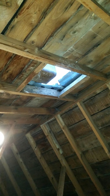

Building up is pretty easy!! I ripped the roof of myself, cost me 500 bucks for two dumpsters... Few good scrapes and bruises too...
I went with open web trusses, they cost more but didn't require any load bearing walls with my span... They also came with an engineered layout of exactly where they go and where to put screws... So, easy to install... We had the trusses and floor sheeting installed in a day... It is solid too...

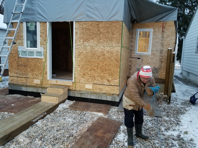

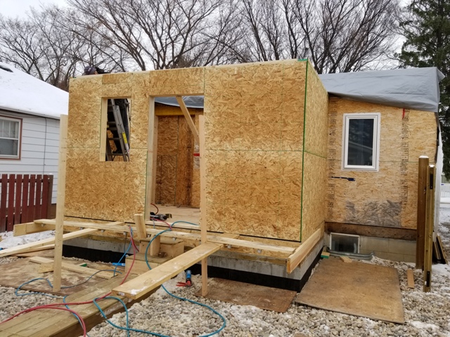

We got some more building done on the weekend, the main floor rear addition...
My cousin, the pro framer and all around cool guy!!
My Dad helping clean up, it's a family project... My Uncle and Cousin live three hours away, so they have a six hour drive to come and help for a day...
Next up will be the second floor walls and roof... They will come up for a couple days to get that built... I just have to wait until they get some time between framing jobs... No problem, no rush!!

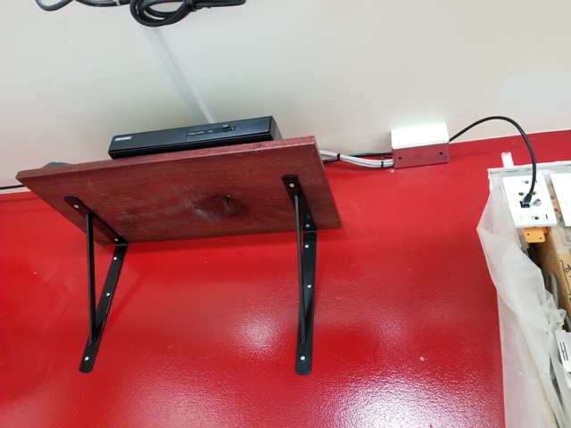

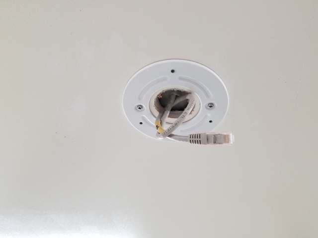

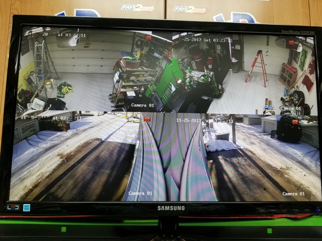

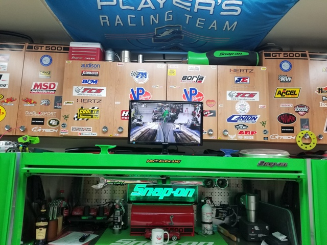

Security camera project...
2 cameras outside,
2 inside,
Recorder and poe supplier, purple heartwood shelf!!
Monitor,
Views, I still need to do some adjustments, but pretty close for first guess while installing the cameras!!
