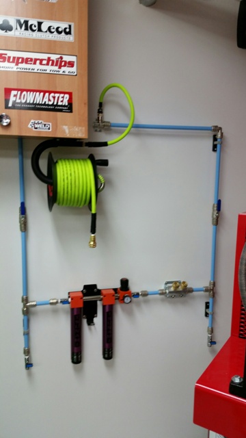

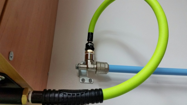

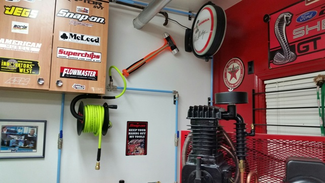

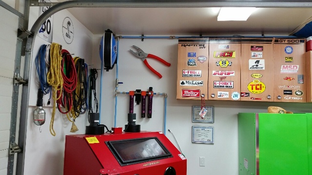

Finished the hose reel connection!!
I think I will move the couplings to the bottom of the manifold for less stress on hoses when plugged in...
Learn as I go!!

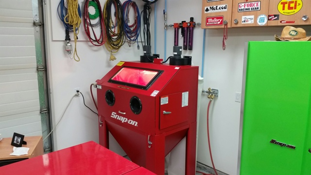

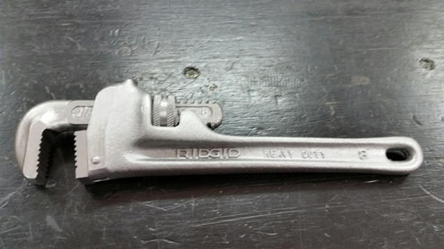

Got the blast cabinet going!!

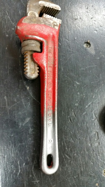

It came with some glass media, so I grabbed a rusty pipe wrench to try out the blaster..
Works great,
I think I will paint it green!!
Also hung up my demo pliers and hammer,

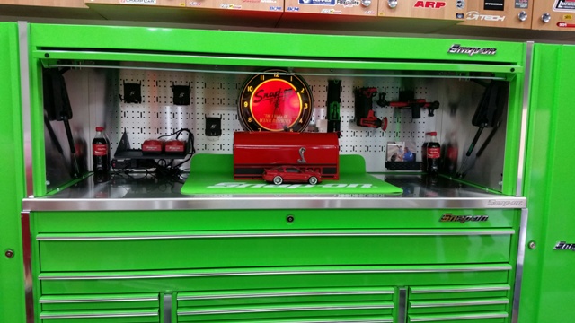

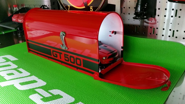

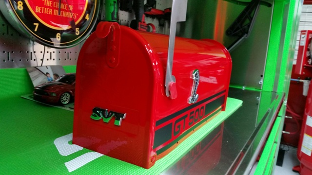

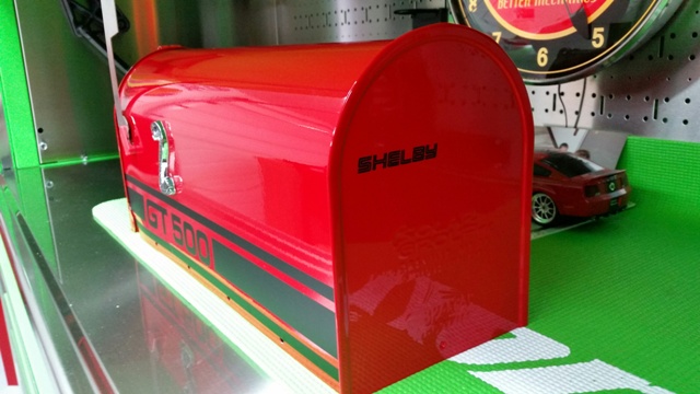

That was delivered to the office on Thursday... Turned out to be a surprise gift from one of my car buddies in Virginia...
Mailbox that was painted to match my car!!
New garage for my RC Shelby!!
If I put that outside it would get stolen in my neighborhood, so I found a good home for it,
My cat claimed the box,

Is that a light inside the mailbox, or just a reflection? I wouldn't let my mail currier touch that mailbox either. I'm already on my 3rd box, since they drive off while holding onto the door before its latched completely.

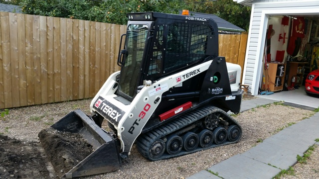

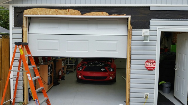

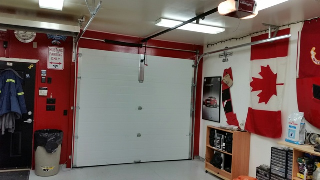

I need to get a kaboda track machine in my backyard to screw in some piles... The only way is thru the garage... I have an 8 foot high double door facing the alley, and a 7 foot high door facing the back yard... Drive thru!!
The machine is a few inches taller than the 7 foot door... The opening was framed for an 8 foot door, and then another header was placed for the smaller door...
I am going to cut it back to the higher header and install an 8 foot high door, that will get the rails and opener another foot higher too...
The sides will just need to be recapped,
Double header!!

Nice sandblast cabinet, I need one of those :) That mailbox is sweet! Nice friend :beer:
I love the blast cabinet!! Dee Blast Industries makes them for Snap On...
Great friend that I haven't met yet!! We both have posted at the same mustang forum for years!! A few years ago I sent him a couple Inuit soapstone carvings and some Canadian Purdys chocolate, been going back and fourth ever since!!

Is your air hose reel a Legacy? I have the exact same one and it has worked great although I did have to rebuild the swivel a few years ago as it wore out.
I have a MAC blasting cabinet that is very similar to yours. I have had it for 25+ years now and works great. You will love it for detailing small parts. It never fails, I always seem to run across a bracket or something that needs to be bead blasted and repainted.

Hi Mike!!
The hose reel was labeled Campbell Hausfeld, I bought it at Canadian tire around 15 years ago!! Not sure who makes it for them...
I just replaced the old 1/4 hose with a 3/8 Flexzilla!!

Gotcha. It looks identical to the one on my wall labeled by Legacy. I purchased mine probably in the 15-18 year range as well, but had to rebuild the swivel 4 or 5 years ago now. It's been working fine without leakage since (knock on wood).
I am also currently running a 3/8" Flexzilla but I think I am going to go back to my rubber hose as my Flexzilla doesn't lie flat and becomes a trip hazard much more than my good ole' rubber one, although the rubber is a bit heavier.

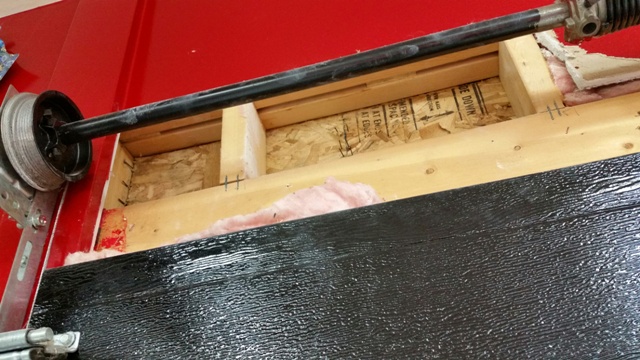

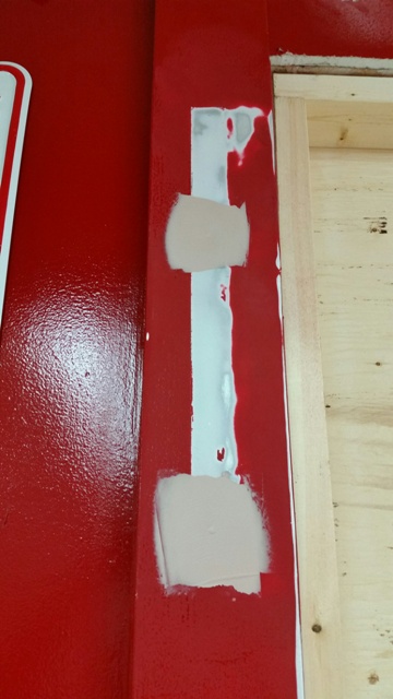

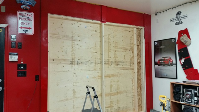

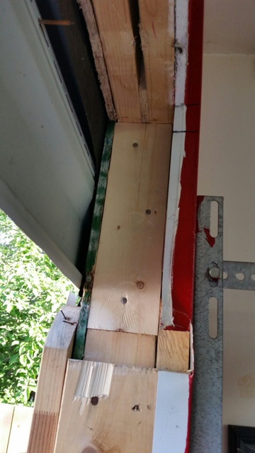

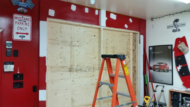

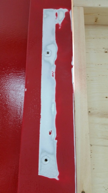

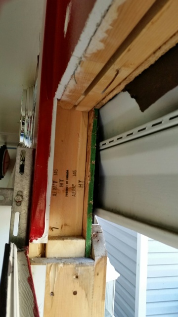

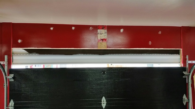

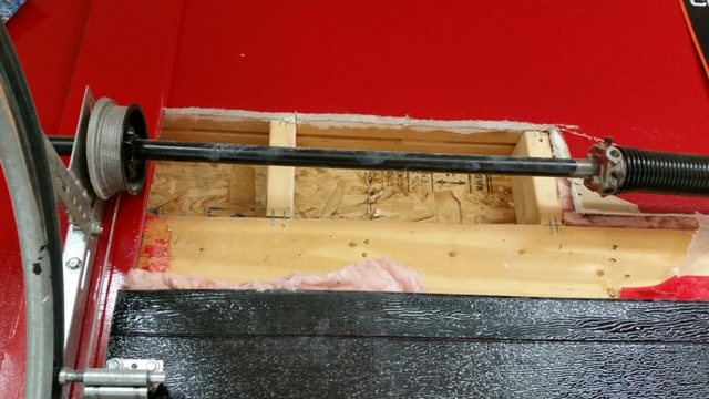

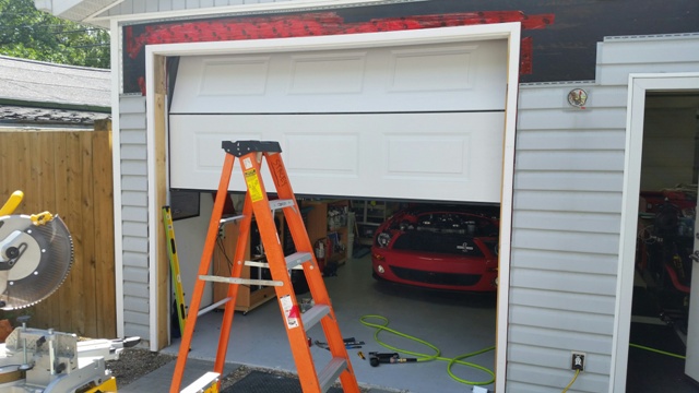

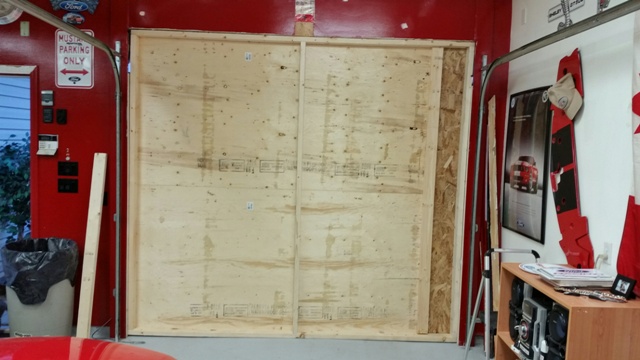

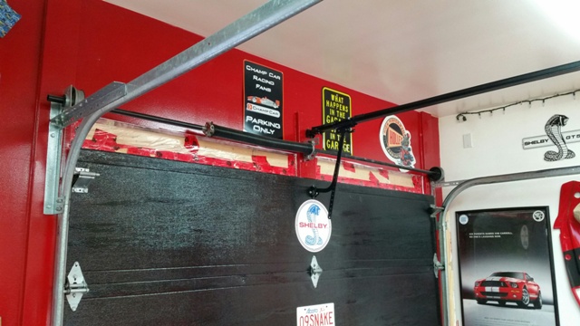

Got the lower header out!!
Filling in the bracing where the old header was,
Last night I closed it in temporarily, the new door is going in tomorrow...

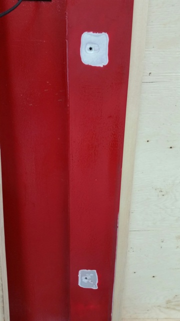

Today I am filling the holes where the old rails were, then I can paint it...
It is metal capping so I need to run and get some bondo, I don't think spakle will stick to it very good!!

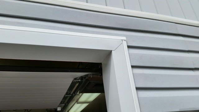

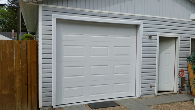

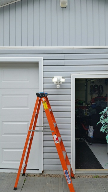

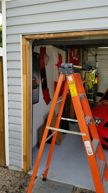

Finally got the outside of the new door finished...
I replaced the brick molding first,
Then my buddy capped the door opening and fixed the siding,
I finished it up with a new led light,

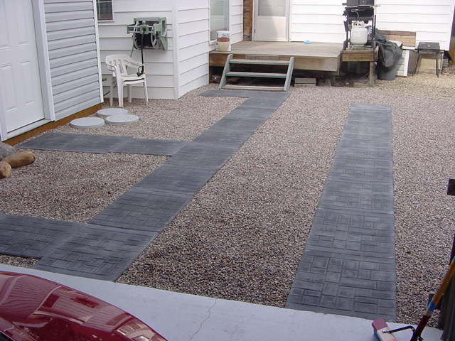

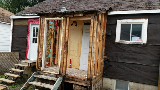

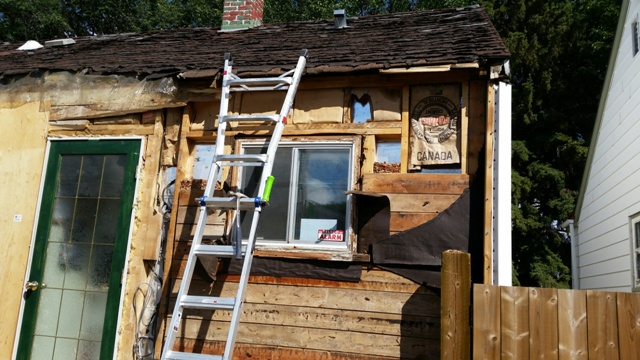

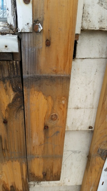

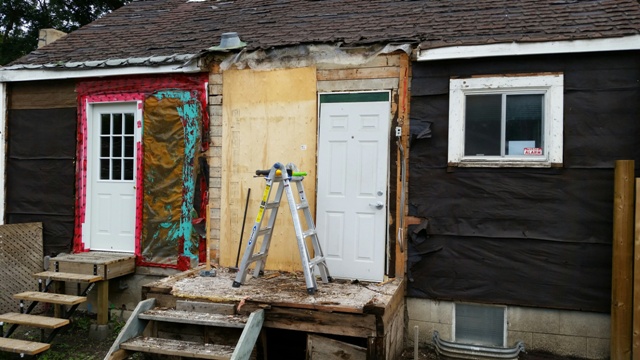

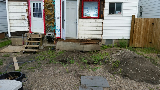

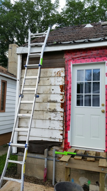

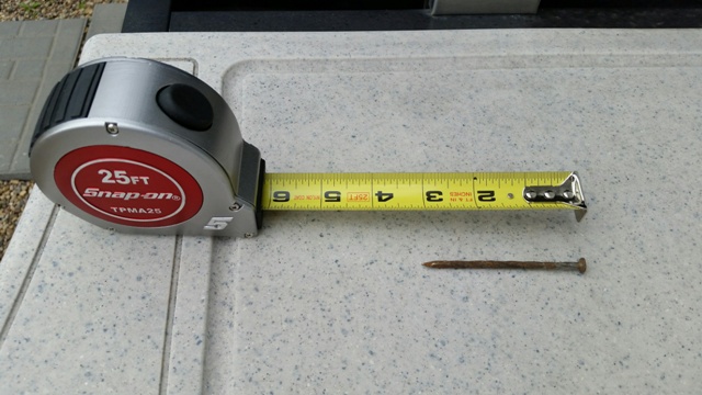

Started on the demo... First is the old siding,
The previous homeowner did the siding, and used 3" spiral spikes about every six inches on the strapping,
The wood siding underneath comes off pretty easy!!
This old porch has to come off next...
O
OCD
Dec 30, 2014
1,316
Edmonton, Ab. Canada

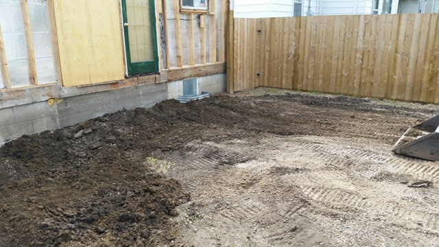

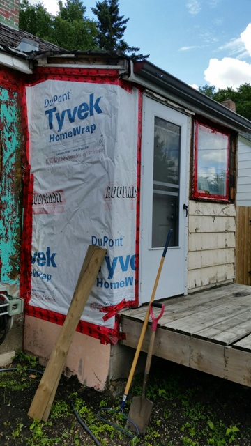

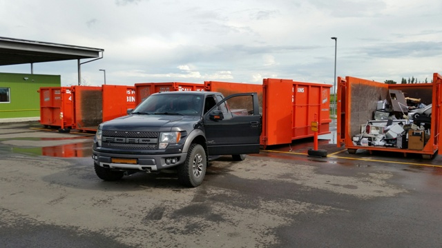

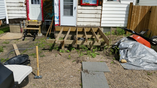

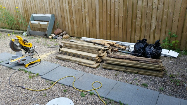

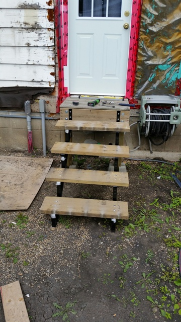

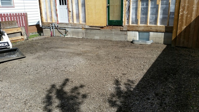

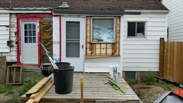

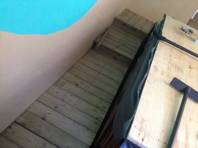

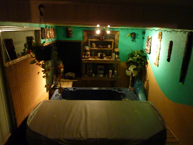

First off was the the old deck,
The door on the left used to go to my hot tub room, it will become the temp door while the porch opening is temp boarded up...
I reused some wood from the deck for the steps and landing,
I will take this junk to the office dumpster!!

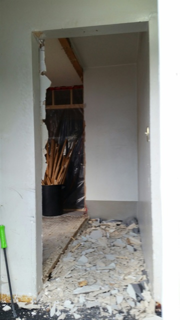

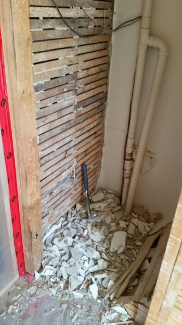

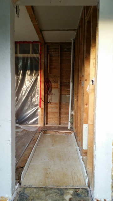

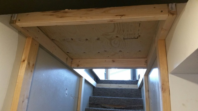

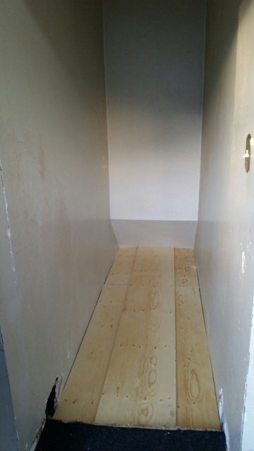

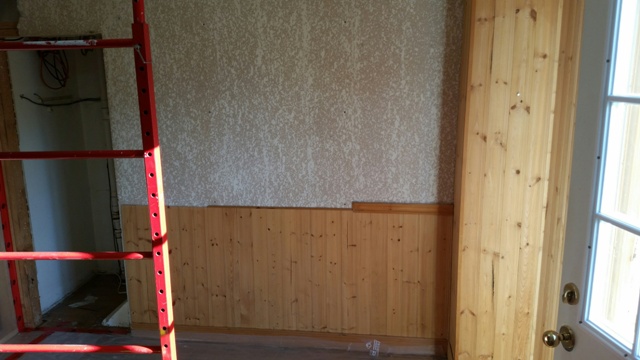

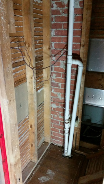

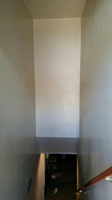

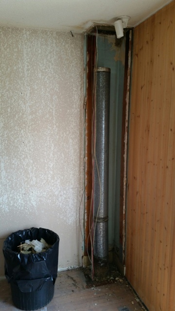

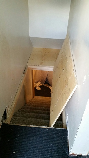

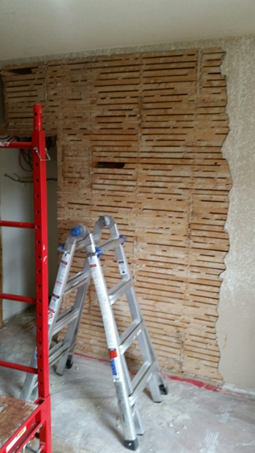

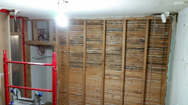

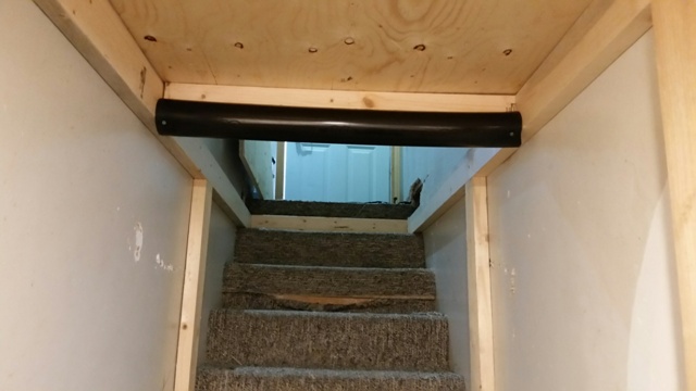

Some inside demo going on!! Wall has to go so I have access to the basement once the porch comes off...
Other side, next!! Going to build a temp floor over the steps...

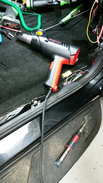

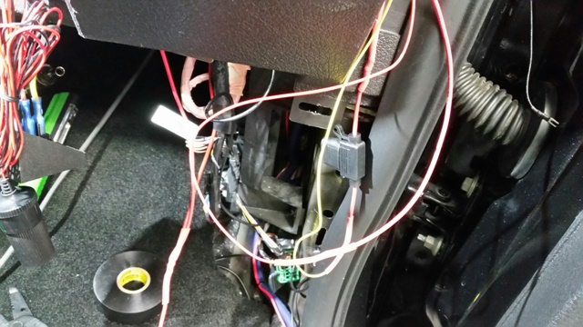

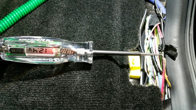

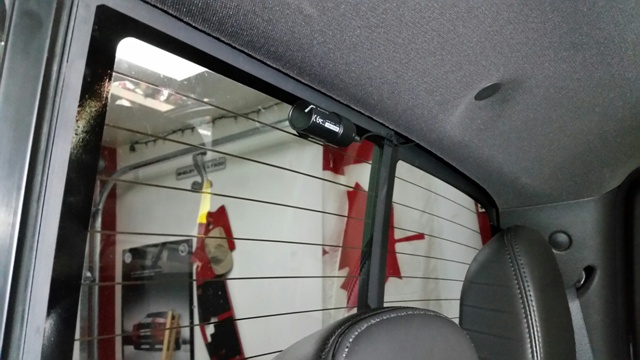

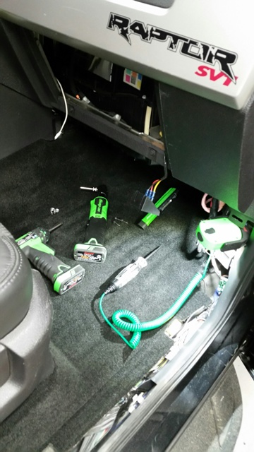

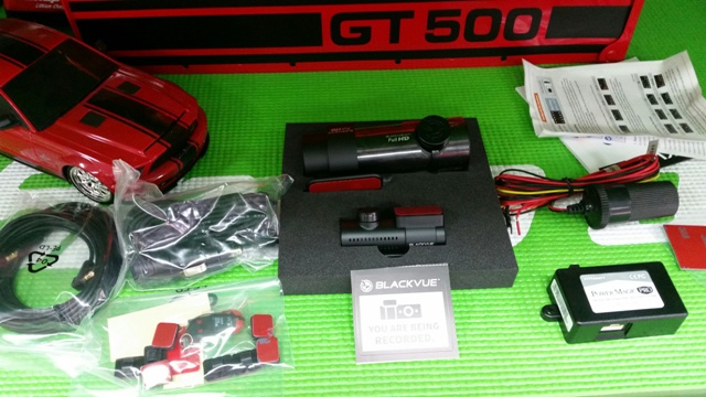

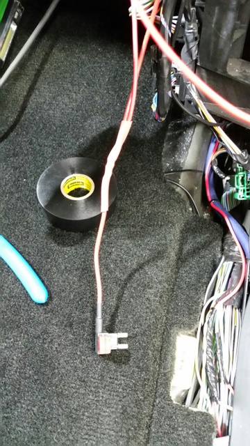

Installed dash cameras in my car and truck this week!!
Hard wired both of them with power boxes, and saved about $300 bucks by doing the install myself... Money for tools!!
Took a few pics of the install in the truck,
Constant power!! First wire I tested for it too!!
Soldered and heat shrunk connections!!
Ignition power,

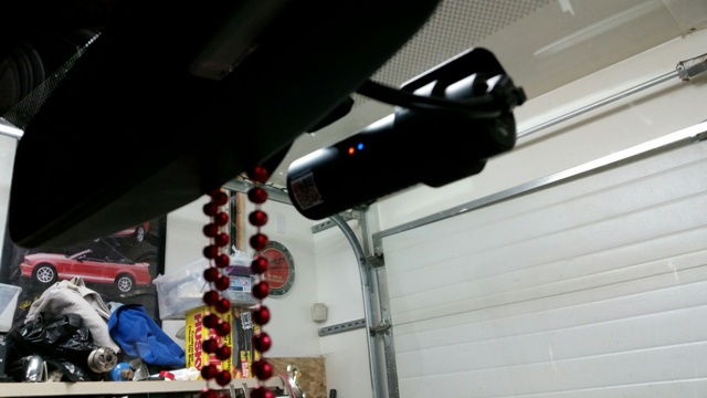

Front cam,
Rear cam,

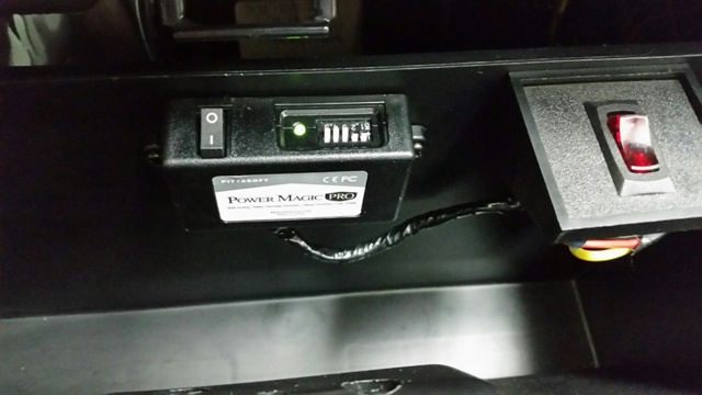

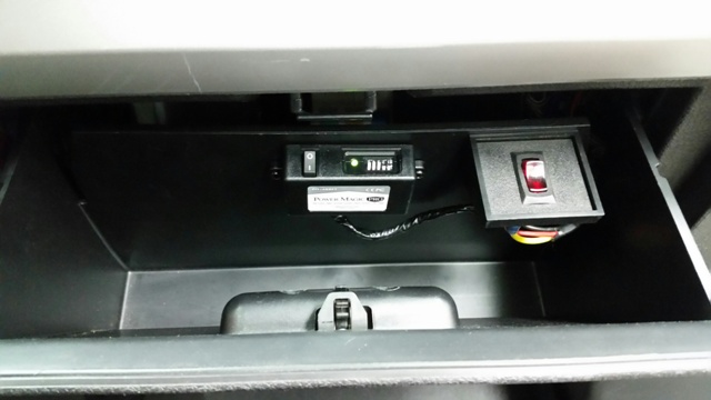

Power box that runs the camera... I have them set so the only time the cameras turn off is if the voltage drops below 11.8V...

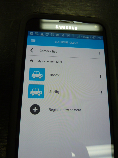

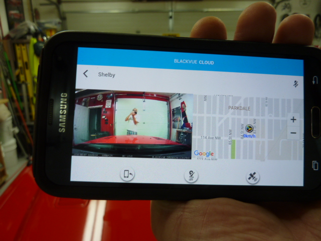

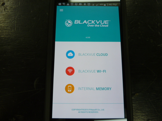

Both have wifi and cloud service,
Live view pic!! Lol...

That is cool! Did the kit come with everything you need? Where did you purchase if you don't mind, how much? I have seen those Blackvue kits before and they get good reviews.
O
OCD
Dec 30, 2014
1,316
I purchased it local for 300 bucks... The "magic box" power supply was 40 bucks... I added a fused link, but the kit came with everything else... It is a basic install, fairly easy...
They are priced pretty good on amazon... There are cheaper ones out there for sure, but I like bells and whistles and the blackvue has a bunch of them!!!
The video and sound quality are awesome, night recording is great too...
The cloud service and wifi are pretty cool too... I connected the wifi to my home network as a hot spot... If my truck gets hit while parked on the street, the camera will send me a push notification letting me know...

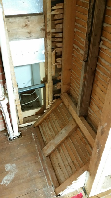

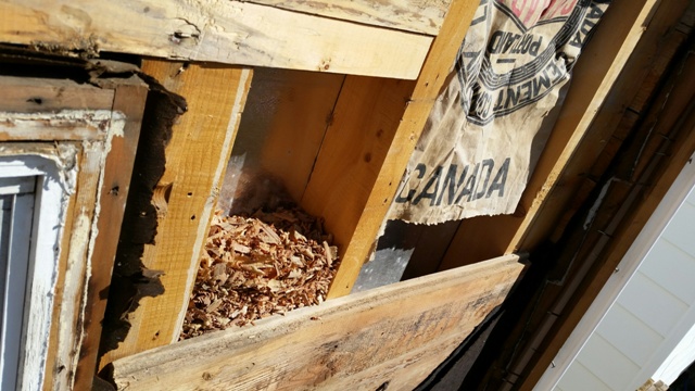

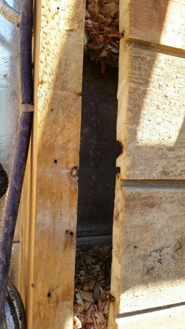

Paper and sawdust insulation from the 40's...
big gaps from settling too,

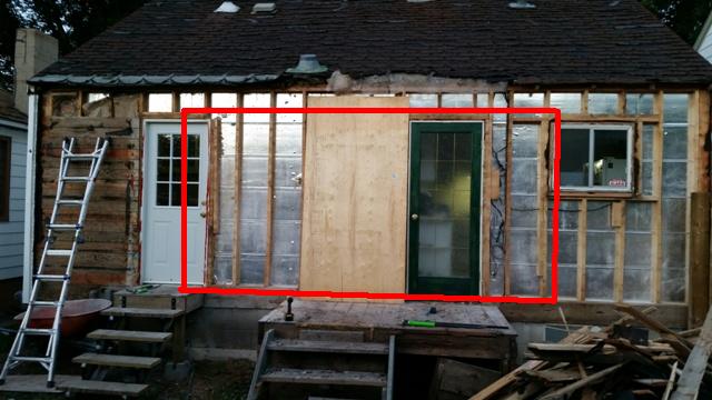

The new opening for the addition will be about this big,

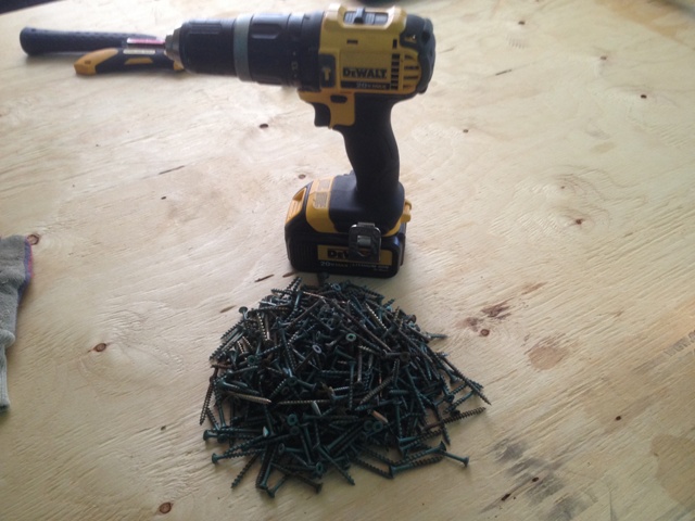

Great read/pic/detail all round thanks - love the pile of nails post demo (OCD is right!)
Likely your refurb will be much better done ... Looking forward to it.
