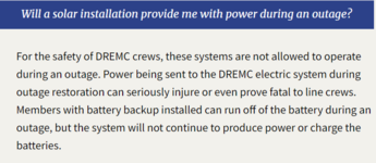

The POCO is a co-op. You can sell back to the TVA....separate application and fees apply.
Yes on the propane for water heater, stove and a 7-10kw gen set. I was just replying to a comment on how cheap and easy oil changes are/were. Our current home has 8" walls, 2" closed cell with blown cellulose or rock wool making up the rest.
This is directly from their website.
I'm assuming a battery/inverter system will have a transfer switch just like a generator so why won't they let your array charge the batteries instead of letting you be in the dark like everyone else?
In the past I was interested in purchasing a meter mounted transfer switch. Was allowable only if I leased it from them.
dcg9381
Jun 20, 2018
12,124
Austin, TX
I understand, based on that policy, why it's confusing.
No, PV solar does not have a transfer switch. These systems "turn off" during grid outage and do not produce any power. You cannot use them during a grid outage (at least without battery storage). More recent systems include "rapid shutdown" modules which are NEC compliant systems that are so fast that you don't even need disconnects - they actually disconnect the DC panels..
You don't need a transfer switch with PV solar... At least not with any inverter that I've ever installed.
The solar systems that have batteries are going to be "smart" enough to not backfeed the grid when the power is offline. I think the POCO is calling out how they work (below) incorrectly, but I assure you they are designed not to back-feed the grid.. If you look at the design diagrams of may of them, they are typically shown with the house sub panel downstream of the power main.
The below is from Tesla:
https://www.tesla.com/support/energy/powerwall/own/best-practices-during-power-outages
Note apparently the Tesla system can also integrate with a generator... Which again, is a bit of a newer function.
