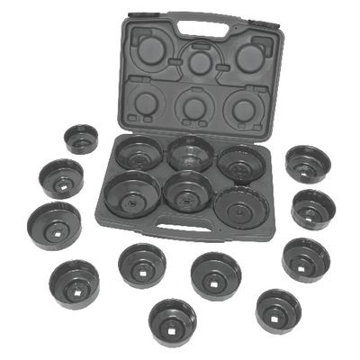

Personally I prefer the filter cups but they have to be high quality (not stamped). Assenmacher makes good ones and I also got a KTC one last year for the small Honda filters that is well made.

Lisle 63600 and 63250 works everywhere it will fit the filter. Pliers or the band types don't work on any vehicle I've owned over 10 years
This. Use both regularly, never failed. Must for my wife's new Mazda; can't get a strap around it. The only complaint I've seen against these is that you can't use them to tighten the filter, which you're not supposed to.
