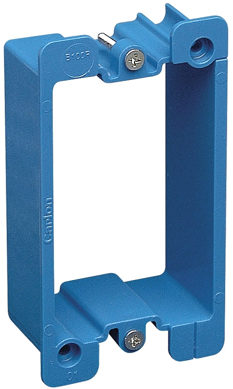

Anyone know of an old work box that will work with 2" thick walls?
I am adding an outlet above the kitchen counter, and the wall is 2" thick from the tile back splash

What is 2"? The thickness of the wall, the cavity, or the distance from the face of the wall to the back? There are some specialty boxes that are available.
The wall is 2" thick (tile, mortar, some sort of backer board/drywall), the cavity is is ~5 1/2" deep from the face of the tile to the back of the wall cavity

I think OP means his wall veneer is 2" thick and a 5-1/2 cavity . the issue is mounting the box to the studs.
can you get in to add some wood blocking or something to secure the box to? or secure a block by screwing from the other side of the wall to mount the box on? or mount a cleat to the back of the wall with screws to mount the box to ?

I am using a GFCI, I got a 3 1/2" deep old work PVC box, but the tabs only go back 1 1/2" so it wont reach behind the mortar to clamp. Longer screws will push the tab way past the track they ride in that keeps them vertical.
I saw the metal boxes with the plaster ears, but I don't think there is enough tile to drill and use wall anchors, plus the GFCI wouldn't fit in the box, the ground screw stuck out to far and hit the bottom of the box

Metal box with Madison bars. No wall anchors needed.

Use longer screws for the pvc box? I'd get one of these and use a longer screw. I do it with old work light boxes all the time. You could also shorten the bracket with some snips.

I've seen long Madison bars that would work with two layers of drywall, but I don't think they would work with 2" wall covering. I have the standard depth on my van and I know they won't work.

Most are 1.5”. But the photo I posted are 2.5”. That might work. But if a stud is there a smart box would be good.
The Allied box looks like it may work with that style of clamp on the back, Thanks!

I was concerned the screws wouldn't go into he studs to well due to the wall thickness, but I'm thinking I could mount that box further back so it screws into the studs and add a box extender to bring it flush with the wall.
I just found this while googling box extenders, it looks like it extends the old work tab guides too so it might work with my original old work box I was trying to use
Good find.
Make sure you have the correct box extender style. It appears there is an old-work box style extender (the one you want - pic on left) and also a new-work box style extender. Part #'s are very similar. Googling returns both styles under same number. You want the style with the track for the wings.
No mention of longer screws provided for the wings. May need to purchase separately?
Worst case, go back to a steel old work box and cut your own dog ears long enough for the job.

I would probably go for a 4x4" metal box and extension. Screws from the inside into a stud. Use a flat mud ring and a square cover plate. If desired, use 2 gang equivalents for 2 devices.

Do you have anything like these available?
They are pushed in and they spring open inside the wall. You then tighten the centre screw (between the ground screws) to lock it in, they are very solid once mounted. May work with the current wall thickness, if not just use a longer middle screw.

Just for completeness, here is the link to deep Madison bars. As always YMMV.
That said, there are other viable solutions in this thread that would work well.
