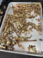

Back on the 964 C2 (remember the rust bucket project!!!)
Plating came back - remember how rusted and trashed that all was? Not anymore - tumbling and vapor blasting is your friend here. That step is pretty dialed in for us, first up degrease, then tumble, then vapor blasting. Then plate and bake (this step is important just google hydrogen embrittlement)
The cases turned out awesome Tim. GREAT job dialing in that process.
Out of curiosity, how well does the yellow zinc hold up on the fasteners? I'm assuming this was how they left the factory, but they didn't seem to retain that finish from the teardown pictures so I'm wondering if the company you are using does a better job and they hold up better or not?

I have a comment from the peanut gallery, please just consider this a FWIW.
I retired from 40 years of aircraft manufacturing working in many different disciplines. I was a QA Manger when I retired.
In earlier pictures I think I have seen washers installed that would be cause for a defect " in aircraft manufacturing".
The only reason I bring it up is caused by the level of quality you're producing.
Washers are made by stamping or punching out the washer from sheet material. As a result, the washer will have a smooth side and a sharp side. In aircraft manufacturing the sharp side always goes against the least expensive part. I have seen vendor parts that have been added to our produced parts come back for overhaul. these parts have thousands cycles on them. One take off and one landing is equal to a cycle. Think of the airplane sitting on the ground at 90 degrees then it goes up into a very cold environment during flight. The metal of the airframe shrinks and grows, the parts the come in for overhaul show signs of the plating being scratched, shaved and rubbed down to bare metal under the washers that were installed sharp side against the plated part. Parts with washers installed with the smooth side showed none of this damage.
Again, this is offered as a FWIW, I have a great Amont of respect for what you've built and what you're producing.

Not to hijack Tim's thread, but I have often wondered about flat washers and whether or not they have a specific direction they should be installed or not. I have not really gotten any definitive answer, so I generally install the smooth side so it is visible, so it would be facing up with the bolt head on the smooth side.
Your comment makes sense, but can you clarify? Are you saying that if a bolt head is contacting the washer, it should contact the sharp side as the smooth side should go down onto the more expensive component, such as the case or cylinder head, being that the bolt (fastener) is the least expensive part?

Thank you for your input. I have always been taught the complete opposite that the finish side goes up! Wow never knew this! Thank you!
This is knowledge I take for granted and I am grateful for you sharing your insight with the people! Thank you for that!
BORING HOP YARD
Jan 13, 2007
1,115
Boring Oregon
Yes, Mike your correct, the sharp side would go against the bolt not the cylinder head. I am sure you have seen what happens when head bolts were installed sharp side down against aluminum heads. In some cases, Engineering would spec out fasteners that had a washer under the head with sharp side towards the bolt head and two washers under the nut with the two sharps sides going against each other. Also want to thank you for your contributions you share.
