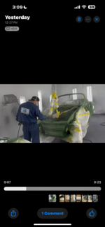

Updates Both the 993 Cab that came in last week and the 964 rust bucket from the previous week are well on their way at paint. IMG_0423.jpeg
Here is the 964 C2, sanded down to bare metal where needed. Had a fair amount of bodywork on it that needed to come off. I spec bare metal when I think we need it, then I have the whole car PDR’d where possible so the filler is as thin as possible. Yes I am well aware that costs a lot more and takes more time, but we try and build things that look the same 20 years from now as they did on delivery day. Final product is only as good as the prep work IMHO. Could be wrong but that is my process.
993 Cab is also down to bare metal. This one is getting a color change so a bit more work is involved. I am really happy with the teams progress as we have only had the car in our possession for a week. I need them both back by 02/01 from paint so I am extremely grateful for the team jumping on it. This is one of those situations where volume and paying what it is worth really helps out when you do B2B work.
Side note: These photos make me cringe when I see how big of a mess the paint shop is - Reason number 1 while I will never own a paint and body business! My OCD would cause me to have a heart attack!

Update on the 993 cab
Primer was applied on Wednesday and the team got on getting on! Sanded and body filler all sorted out. 4 guys are working on the project to meet our deadline.
Got painted yesterday. Remember this car was black? We are changing it to leaf green.
Hoping to pick the car up January 9th so we can start reassembly. That’s a 3 week turnaround at paint and I am pretty happy about that.
Meanwhile back at Olsen we are busy on that car doing sub assemblies. This car is a late 90’s car and by that time yellow zinc was getting replaced with white. The engine still stayed yellow as it was a lot of NOS/left over parts. So a bit of a mix match which puts more pressure on the sorting department. Kind of is what it is in those transition years.
Quite the difference from last week!
