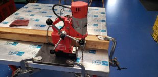

I tried, but I still hafta crank the (10 TPI) lead screw on the XY table :evil: ... Steve
