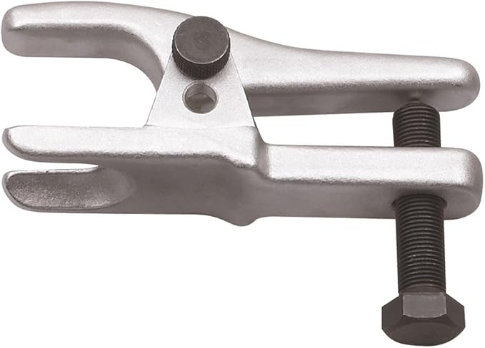

This is all you need for a Honda. You should have stopped when the screw becomes super tight, and then start hammering. I read it somewhere that is the proper way to use that tool.
Luckily, I never had to do that. The tool always popped the ball joints before getting too tight to damage the bolt. So much easier than those brutes who beat with a 10lb sludge, thinking it's faster. It's not: the tool takes 10 seconds to put on, and another 3 seconds with impact.

Please don't make assumptions about how the tool was used. If it had not been used moderately I wouldn't have been saying bad things about it.

The weakest point of this style ball joint tool is the pivot pin: not thick and bares all the force at a vulnerable direction. If something gives, it's the pivot pin.
I had to guess how you could bend the bolt while screwing it straight down. It's hard to believe that the pivot pin did not bend and threads weren't striped before the bolt was bent.

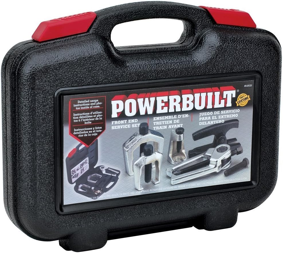

Do the Powerbuilt / Alltrade / OEMTOOLS front end service sets that you can rent from Orielly's or Autozone work?

I have the OTC set and it’s very nice, never a problem with it in 10-12 years I had it. I will never use a pickle fork again. Only problem with separator like vision guru showed is $&&$ gm facotory ball joint use an extra long stud because guess all their assemblers are blind???? I cut most of the stud extension off w/cutoff wheel then the tool works fine. As far as Chinese version I learned with ball joint C press. I bought a chinese one first and quickly destroyed it. The otc has held up great! Would have saved money going with otc in the beginning.
