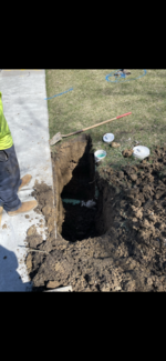

Time to dig in the new septic line. Had to move the old fuel barrels out of the way first !!
These guys do not bring knives to gun fights good grief :lol_hitti
We had to T into the line to add the line to the new house. We'll cap the old house off sometime in the future.
They said they usually run some underground wire for power and the alarm and I said nope ... it's going in pipe so I laid the pipe in. I always used to say pipe was cheap insurance but these sticks are probably $10-15 each right now. Luckily I've been preparing for the shop and new house and have been accumulating leftover supplies from dumpsters and jobsites for a decade now so it doesn't hurt as bad.
The white PVC pipe had pulled out almost a foot when we dug it all out so I put a piece of 6" drain tile around it as a sleeve to hopefully prevent that from happening again.
Pipe is all laid and it's time to backfill !!
I went in to grab a bite to eat and one of the guys ran a packer roller deal over the whole area and turned the dirt into concrete. Good grief. Oh well. It looks nice.

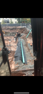

Pops and I put the drain tile around the house and stubbed up the drops for the rain gutters.

What would you use to get the turds to the tank if not Schedule 40 Waste/Drain/Vent pipe ??
It's a loooooong T and seems to be working fine so far :dunno:
That black pipe is literally drainage tile. The 4" pipes that the gutters will dump into are non-perf and the 6" ring below is slotted to allow sub-grade moisture to get wicked away. I hate having water issues so this seemed like cheap insurance. I do not anticipate any issues as there is still 3' of fill under the drain pipe and water should never even get to the drain pipe. Perfect !!
I'm not trying to come off the wrong way here as it seems BUT I'd truly love to hear what you do in your area !!!

personally i wouldn't use flex drain tile around me house. i'd go form a drain or PVC. flex just collapses too readily and you cant send a snake down it to clean it out.
You must have very different soil than here. Every house built here uses black drain tile. If its installed correctly with gravel it holds up fine. Even the 40+ year old drain tile around my current house is fine.

i pulled all the black plastic home depot **** out and put PVC in. the black stuff was crushed and not flowing. might be just the junk that home depot sold vs the good stuff the farmers get.
Huh. I've got around 200,000' of that same stuff underground laid with the tile plow. I think it'll be fine. It's bedded with LOTS of gravel and sand to keep it clean. Not worries about collapses at this point I guess :dunno:

No idea on part number but it is ADS pipe and I can jump on it without crushing it :dunno:
next time you're in home depot compare it to the stuff they have there in 4".
edit: did you pull 8" around the house?!?!
It's 6" slot cut perf around the house. The 4" stuff at Menards locally is ADS pipe. Same stuff, just 250' rolls instead of the 3,200' rolls we get 👍

this is the **** im talking about. I guess ADS = cheap. NDS = quality?
I dunno dude. We've literally laid 200,000' or more of ADS pipe with no issues. I looked up NDS pipe and it looks like decent stuff as well for sure. It depends on the area. ADS only ships so far away, at some point NDS or others will be more economical as their plants will be closer :dunno:
i'm mainly curious if the big rolls you get on a commercial account have a different wall thickness than the stuff from the big box stores. FINE i'll bring some over when i drone to compare. put 5 lbs of bacon on the disk.

Here we have to use green pipe for the sewer. I forget what schedule it is. Here are two examples415B7670-1A78-41C8-A77A-072603163D4B.jpeg C5543B9D-ECC1-4AF6-863B-31C73DE3D7EB.png
The footing drains are done like this around here. Most companies just use white pvc but the company I work for uses the green pipe since it’s stronger.
Nope didn't take it the wrong way at all !! I was genuinely curious about how you do it instead. I'd say the green pipe and solid drain lines are probably more "right" than what we did but this is what everyone does up here so it seems fine I guess :dunno:
Looks like a sloppy mess in that one picture !! Sticky clay is gross to walk around in any kind of footwear :puke:
Sloppy is an understatement. This company has never heard of letting a site dry out. They also don’t comprehend that mud makes more mud when your tracking through it all day.
