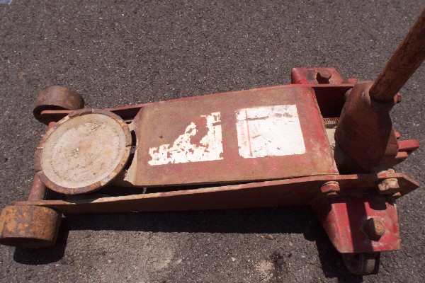

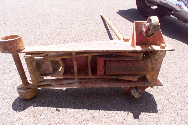

Looking to rebuild my jack. This was a craigslist find--I got this jack plus a chinese craftsman 2-ton for $70.
I have no idea what jack this is, but it was claimed to be US made, has SAE fasteners, and was purchased some time in the 1980s. Bigger than a 2 ton for sure. It is in rough shape, but I'm hoping to recondition it and put it into service. If I can figure out the make/model, then I will try to track down a manual and study it.
On the back frame piece it has the following stamped in:
0000-0911
1 W 4C (where the "W" is in the top half of a half circle)
couple of pics (can take more):
https://lh3.googleusercontent.com/-2vptTRuSiQA/UAIAD6SRryI/AAAAAAAABho/th9ej7Kl0Po/s600/jack1.JPG
https://lh5.googleusercontent.com/-lmcoXPYib6w/UAIAEIryeaI/AAAAAAAABhs/lKQQeOedfXQ/s600/jack2.JPG
