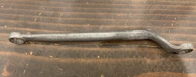

Smokeshow69
8,413
I’m not sure if this is the correct thread but I wonder if this Wright Aeronautical offset wrench would have appeared in a similar kit, if not in this thread title one?
img_1330-jpeg.2191320

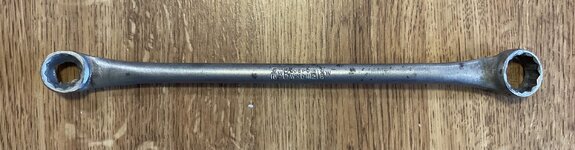

Leviton
Feb 25, 2019
956
Oregon
I found this guy in the midwest at a thrift store last week.
It is marked:
5/16W-AT-8008
WOEX110
601
It looks like it was probably cadmium plated.
I've read through the thread, and I'm still a bit confused. I'm trying to figure out what I can say about this wrench. Can you help?
- Based on the WOEX110 marking, is it safe to assume that this wrench was made by Snap-On?
- It looks like there was never a firm decision on what the "AT" means. Does the "AT" marking at least mean that it was made to be part of a tool kit, or for aircraft, and was not a wrench that was available to the civilian auto mechanic or to the general public?
I only need one tool to finish the set. Its a six or eight pronged socket model AT9209.
THIS ^ is pretty exciting! I wish you luck. Looking forward to hearing you finally acquired the last piece.
Dave455
Mar 19, 2013
5,843
Sussex, England
It is marked:
5/16W-AT-8008
WOEX110
601
Good find!
Snapmom, as always, has the definitive answer!
A couple more bits of info.
Yes, a Blue Point wrench at the time, which later became branded Snap On.
Snap On still make essentially the same wrench, with essentially the same part number. Here’s one of mine.
Blue Point made quite a selection of tools in Whitworth / BS sizes.
Here’s a full length box end wrench.
The aerospace style wrenches in BS sizes are relatively hard to find. I have a fairly full set of the Blue Point, and I know of a couple of other sets, both owned by aircraft engineers.
The fact that these wrenches are circa 80 years old, and still in use, is testament to the quality.
No, I don’t think we ever definitively established what “AT” means. All the tools do seem to be for aircraft applications, but they are not exclusively Whitworth / BS, and certainly not exclusively for Packard Merlin tool kits (though that’s one of the places they are found in the U.S.)
Here in the U.K. we see a good many of the tools. Some of them “AT“ marked, some of them not. I’m keeping an eye out for Snapmom’s outstanding AT9209!
