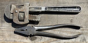

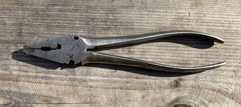

Here are two tools shown in the above ad that I found at yesterday’s Walnut Creek estate sale. IMG_1260.jpegIMG_1261.jpeg
