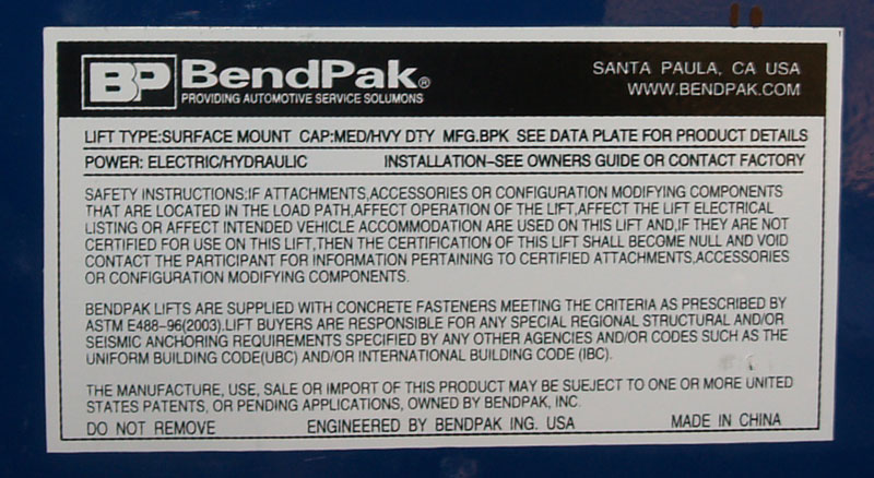

I just finished installing a BendPak 10,000 lb. XPR-10A-168 lift in my shop. It took two full days (with the help of a friend) to assemble it, and another full day to wire it up. Not too bad considering neither of us old guys had ever installed a lift before.
The lift is well made but I thought is was made in USA when I ordered it. The label on the power side column says "Made in China".
