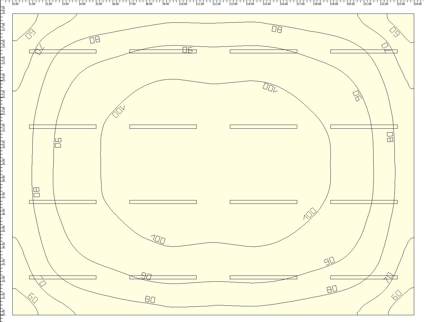

Finally built a 18' x 24' detached garage. It has 8.5 high ceiling and it will be insulated and sheet rocked. I am at the rough wiring stage now.
The outside is not quite done yet.
I want to go with LED, I don't want to have deal with fluorescent tubes and I always seem to have a bulb out.
I have looked at these lights at Lowes https://www.lowes.com/pd/Portfolio-...mmon-4-ft-Actual-14-8-in-x-52-07-in/999911229
I was thinking of 4 lights, two lights centered at 8ft from front of garage and 8 ft from back of garage running parallel to the sidewalls. But not sure how far they should be from sidewalls? Will 4 lights be enough?
The back of the garage will have cabinets and a workbench.
I will be primarily finishing the restoration of my car putting it back together. Then it will be used for general maintenance polishing/oil changes and hanging out in.
I am wondering what other options I have?

LED is a wise choice :) I think four fixtures would be enough. As for as placement length and width, divide both X and Y by three and hang these lights on the centerline respectively. I hope it makes sense to you it makes sense to me. If it's unclear I will try to clarify it for you. With that said I think you'll have enough light. I forgot to put in there with respect of white wall paint :)

I assume you don't want the retrofit tube strip light look for a fraction of the price. Though you can do better with respect to efficiency, price and bang for your buck, I used the Cree LS4-40L-40K for the following layout:
(pic linked to larger image)
Here's the PDF report: casmurbax.pdf (link)

The lights you used in your layout that you provided are about $2k am I understanding you correctly that if I went with the retro tube strip, I could do better with respect to efficiency and price?
Or are you saying that Cree LS4-40L-40K is would be better efficiency and bang for my buck?

I'm saying the Cree is not very efficient and rather expensive, as is the fixture you originally linked to. The housing and lamp on page 1 of the best light fixture thread is perfect for your height unless you really hate the look. Hang on - working on a layout with that in it.

You see why the 4 fixtures you thought would be enough really aren't good enough. Platonic gave you an excellent arrangement with 16 that will give you fantastic lighting which will energize you and encourage higher levels of garage achievement. It did for me! ;)
I installed 5 similar LED twin tubular fixtures in my 10x20 work area with 4 extra LED floods angled toward the wall shelving and 3 extra LED floods shining downward directly over my 7 foot workbench.

Here you go:
Here's the PDF report: casmurbax-1.pdf
(Just ignore that the report says James lamps. I edited the attributes of the IES file to simulate the Lumengen tubes.)
12 housings + 24 LED tubes:
Best bang for the buck LED bypass 4ft 2-lamp strip light as of 8/25/2017:
22W LumeGen 4ft single end bypass tube
2640 Lumen
120° Beam Angle
$6.99 ea.
Free Shipping over $25
Maxlite LSS2XT8USE4803 75303 2 Lamp T8 LED Tube Ready 4 ft Linear Utility Strip Light Fixture Pre-Wired [Min Qty: 10]
$15.96 ea. x 10 = $159.60 (Free shipping over $95)
coupon "10offshine" to get $10 off

casmurbax - The fixture you originally linked to claimed 5000 lumens @ 68W. Thus 74 Lumens per Watt, which is worse than most fluorescent fixtures. There's certainly nothing wrong with buying a complete LED fixture with better aesthetics than your basic retrofit strip light, you just need to dig into the specs so you know what you're really getting.
