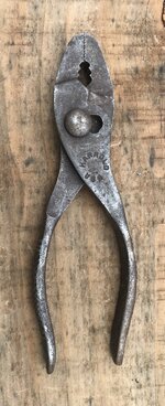

Trying to ID these pliers with circle H mark nothing els. Don’t know about Craftsman, don’t believe Herbrand ?
Any ideas ?

Everything BUT the circle-H is Harrold. I have not seen a circle-H on Harrold pliers before, but there it is. Sears did contract with Harrold, but AFAIK, only for the “HappiTime”-marked boys tools set slipjoints.

rustyedge1
Jun 11, 2023
131
Indiana
Do you think these are Harrold pliers ? They look like those I’ve seen.

LesserSon
Feb 7, 2016
5,053
PA USA
Yes, unequivocally.
Here are some examples of mine.
I cannot explain the H-circle. I don’t think Craftsman had any protected rights to their manufacturer codes, so I don’t think New Britain has anything to do with it. I also don’t imagine Sears would contract for pliers with a manufacturer that didn’t manufacture pliers.

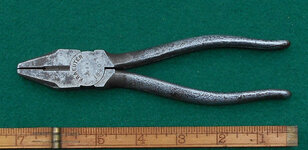

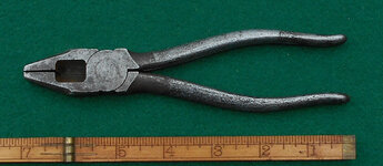

Kraeuter 1130-7 7-inch linemans pliers

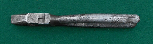

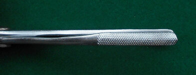

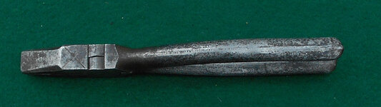

Picked up these long bent nosers at the flea market this morning. Well made. Love the bowed handles. No markings of any kind.
30,523
That hexagonal (or octagonal?) handle shape and the striations at the lower end of the handle look pretty distinctive from here!
Hex. Machined that way, leaving unfinished marks on the outside. The raggedy remains of red insulated handles that were on them when I found them (see below)* were probably original, and possibly a clue to use case. But I'm pretty sure what Outlaw meant by distinctive was identifiable, such as a well-known pattern.
