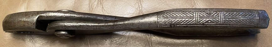

Don, I was looking through some design patents, and spotted AA Kreauter’s 1921 grip pattern, which DATAMP says was marketed as “Beauty Handle.”
It’s not identical, but similar enough that it seems like it could be the inspiration for, or common ancestor of, the two grip patterns we were comparing on Danielson/Pendleton and SK/Japan slipjoints.

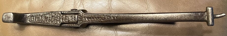

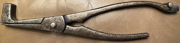

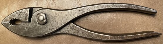

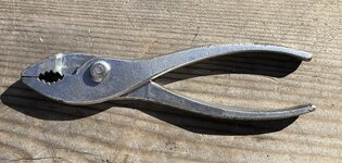

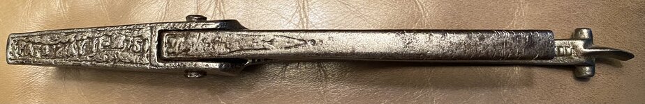

While I’m waiting for the universe to resolve that, I’ll post two damaged pliers that I inherited, each from a different grandfather.
“Little Wonder Chicago / Pat May 11, 1875”
US163277.pdf
And “UTEE-Co,”which I’ve tried to rationalize as a collaboration between JP Danielson and Utica Tool Co or the Utica Cutlery Co to go head-to-head with Crescent’s “CEE TEE Co.” Only, just today, I realized it’s not a “U” - it’s “JTEE-Co!” Just Danielson, then.
EDIT - Except, I’m wrong! IMG_7751.jpegThere’s a pair of Danielson-mfd diamonds-grip pattern slipjoints on eBay that very cleary say “UTEE-CO / UTICA, N.Y.” with S91 code on one handle.
I think that’s X92 and V13 for alphanumeric codes.
EDIT - found catalog evidence that Danielson did mess around with cute brands. Dan-Co JimIMG_7574.jpeg
EDIT - BTW, here is a pair of Utica Cutlery Co slipjoints for comparison.
Interestingly, the row of coarser teeth is shaped to fit flat-sided, rather than round objects.
