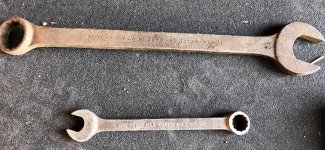

ALL: these Plvmb wrenches don't get my attention as much as the Pebble ones, but I can't say they are poor quality so I usually buy them if they are available without breaking the bank.
hammer just was cool and was part of the deal and not sure if it might be a PLOMB of PLVMB or some other brand, but i thought it was cool looking.
