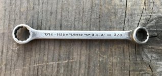

I know this is nothing compared to what all you heavy duty Plombers have, but I got this yesterday and was quite excited. It was the first pebbles I have seen in real life.
