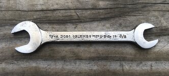

Ill throw this pic in here to research info

photo taken for Private Lugnutz's other "figure this out" thread but I'm posting here as well.
I think that Don gave me a heads up on the ratchet, which I grabbed off ebay. The socket set was purchased separately.
Did Don send me the spinner?
Sockets run from 3/16" - 7/16" (6-points) and there's one 4710S 8-point. (I'm missing one, right?)
Sockets appear to have a cad or phosphate (?) finish. NOT sure if the ratchet is period-correct to the set or not.
CODE stamped on the ratchet ONLY. As near as I can make out with my big magnifying glass, it's VC
Plomb 1/4" drive SAE socket set w/ ratchet stamped VC

Based on the Survey thread, I decided it was time to get the Plomb family together for a class portrait. This is all garage / estate / flea market finds over the last few years, nothing with any real provenance back into the family.
First off, the items I posted in the survey thread.
Top 5420 1/2" drive 5/8" Los Angeles, 6F stamp (oops, this doesn't belong in this group)
Middle 1218 9/16" combo wrench, Made in USA, LC stamp
Bottom 4749 1/4" ratchet made USA, NC stamp
Next up, the big pieces
Top to bottom
Box, unknown number, probably for 1/4" socket set , 6.5 x 2.75 x 1.25
Extension 5463, Made in USA
extension w hole 5461, Made in USA
Wrench Marked Proto 1222-L MFD.USA PLOMB TOOL CO 11/16" combination
Ratchet 5449 (pebble?) MADE IN U-S-A- (don't have a centered dot handy, so used a dash)
Wrench 1216 MADE IN U-S-A- 1/2" combination
Wrench 3031 MADE IN U-S-A- 5/8" 3/4" DOE
And finally, the sockets and tiny wrenches
Top L-R
1/2" drive 5434 1-1/16" MADE IN U-S-A-
1/2" drive 5425 25/32" MADE IN U-S-A-
3/8" Drive WF-77 C mark Swivel 11/16"
3/8" Drive WF-76 C mark Swivel 5/8"
3/8" Drive WF-33 3/4"
3/8" Drive WF-25 1/4"
Wrenches L - R
3216 Raised Letters 7/32" 1/4" Ignition fat beam U.S.A (angled sizes reversed from below)
3018 recessed panel (don't know the right name) 1/4" 5/16" Made in U.S.A
3216 Recessed letters 7/32" 1/4" Ignition skinny beam L.A. (angled sizes reversed from above)
Sockets again all 1/4" drive
4708-S 1/4" 8pt MADE IN U-S-A-
4709 9/32" 6pt MADE IN U-S-A-
4710-S 1/4" 8pt MADE IN U-S-A- K Mark
4712 3/8" 6pt MADE IN U-S-A-
4711 11/32" 6pt MADE IN U-S-A- War Finish CC Mark (vertical C over C) (oops missed this, will update Survey thread and pic)
Edit: And finally, some too big for the box the rest were queued up in, a 5469 Speed Hinge Handle, 1/2" drive. Break it over for leverage, then straighten it out and its a speeder.
WF-2K 3/8” speeder
And as noted above, I don't have any real attachment to these, so if a piece will help you complete a set, can be up for a swap.
