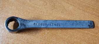

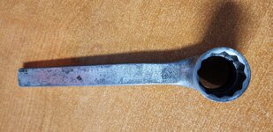

Hmm, very possibly as plomb was a ranger contract supplier. You need to post it on this thread as the people in the know about the AT tools will be able to advise.
Thanks. I'll post it there.
MR.X
Dec 13, 2010
1,838
Could this be a plomb made wrench?
That kit had 3 flat handle fixed socket wrenches like that, the 39 (11/16), 450 (13/16) and 585 (3/4) I have a 39 and 585 marked Plomb and another 585 where the fixed socket portion is a Blackhawk Both my 450’s resemble yours with no brand name and an uneven shop look to the stamping. Sooo..make of that what you will.

Then you need to get the Packard Merlin engine to complete the set. 🤪
The Fairchild Ranger 6-440 and Packard Merlin V-1650 both have tool kits with "AT" (or A.T.) markings.. but like in the My Cousin Vinny court scene where Tomei says "the Corvette which could never be confused for the Buick Skylark", the Merlin Engine is significantly different than the Ranger 6-440.
31,056
...giving credence to my oft-repeated still unproven theory that it ("AT") is not actually an arbitrary industry prefix, but a government, perhaps a USAAF thing. It's my understanding that the Fairchild and the Merlin numbers don't overlap, either, which would also make sense. Or I could be wrong. It could just be an independent coincidence. There are plenty of aviation toolsets (e.g., PWA, etc) that don't use the same scheme.
Correct. They do not overlap.

Thou the Merlin Packard AT8027 valve adjuster does appear on an unofficial, oft circulated Plomb Ranger list. BTW, when I mentioned the 3 fixed socket wrenches, I'm actually not even sure if they were all part of the same Fairchild Ranger "kit". They could have been add-ons, a different echelon kit, or for the follow on, less successful Ranger engine for all I know.
The Ranger AT-39 wrench was listed in the L440 Overhaul Manual as being a wrench for removing unshielded spark plugs. The other two may be for shielded spark plugs, as the hex size for spark plugs was not standardized until well into WWII.

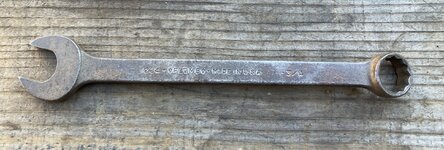

I only found this dark finish 1224 3/4” combo wrench at yesterday’s estate sale. IMG_0187.jpeg
