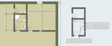

I have my 40x60x16 post frame building up and I am preparing for concrete this week. The plumbers came out yesterday and roughed in the pipe in the ground for my bathroom and a hand sink in the shop. I want to make sure that I vent it properly. I have attached a drawing of the barn and a seperate drawing of how the plumbing was laid in the ground. Above this bathroom and office space will be an open loft so I can't just come straight up vertically from any of the fixtures. How do I vent this the easiest and properly?

You have plumbers doing the rough in but not finishing the vent? Getting the venting wrong will cause lots of problems...i'd recommend working with the plumbers you have, if possible

You need to get up through the roof somehow. A partition wall on the second floor to create a closet can be a good way to do that.

You can bring the vent line back through the ceiling to a outside wall and go up through the roof. Just make certain any horizontal runs slope to the drain so any condensation/moisture runs to the drain.

There currently are not vent lines in the system. The drain piping is just ran in the ground as shown in the picture. Does it matter which sink I use to run a vertical vent pipe up and out to the exterior wall? Do I need to vent both sinks? Could I just vent the main 3" pipe where it stubs out the side of the building? The main 3" line exits the building 9' from the toilet.

Ouch! You need to vent the toilet near as possible to the toilet itself. Seems to me that six feet away is the maximum. That nine foot run to the main will probably **** the water right out of the toilet. Both sink drains need to extend straight up into vents that continue up into the ceiling, then run over to the 3" vent for the toilet. The shower should be ok to vent through the sink drain.

Where in my drawing would you suggest I add a vent for the toilet? I need to make sure this piping is correct before the concrete is poured.

You can use studor vents for the sinks and shower, but you had better get the toilet vented correctly through the roof before your problems are cast in concrete. At least one vent needs to be to the outside in order to vent pressure as well as vacuum. Studors only vent vacuum. Plumbers know this stuff cold. HOW it is vented is important. Why you didn't let the plumber at least stub out the main vent is beyond me. You could save some money by plumbing the vent to outdoors yourself.

I assume sinks are stubbed up above slab, deal with them later. I think you should come off the 3" line to toilet between it and T to sink/shower with a 3" line, roll it to come up through wall if you don't want to see it. (It's possible it could rise through wall between utility and bath but I'm not sure.) Get it just above floor level for now. Then T off shower line and bring it up into a wall.
Later you can connect shop sink to shower vent, and bring all vents to above a dropped ceiling, and one 3" under ceiling/loft framing to exterior wall, where it can rise through roof. Dropped ceiling just needs to be low enough do slope drains it like poorub said.
You can do it all in ceiling framing but a 6 or 8" dropped ceiling will make it much easier, with much less concern about boring and notching framing.

It wasn’t a matter of me not allowing them to run a vent. They just didnt stub out any vents. After I inspected the work I realized there were no vents stubbed out which made me start asking questions on here on how is this supposed to be vented.

Bemerphile's video for the toilet venting covers it. Cut in a wye near the toilet, roll it to the side about 45 degrees and run a 1 1/2" vent up the outside wall. You should have enough depth to run it all under the floor until you get to the wall. You might run it in 2" or 3" and put a clean out when it clears the floor, but it takes more room.
Studor vents are fine, but I would continue the drains up the wall if possible. They become vents as they pass the sink tees. Continue them up, cross the ceiling and merge with the toilet drain then up out the roof.

Can't quite tell by picture, but looks like the pipe is massively oversized for a sink. Pretty sure it's not to code, but was it sized that way to use as the vent?

It's too far away the way it is piped for the sink to be a wet vent for the toilet. It would have been possible to use a wet vent at the sink if it connected directly to the main waste line near the closet ell on a rolled up wye as described by @PoorUB

The lab should have a 1.5” vent of the San tee that the trap will tie into. Run that vent above the sink rim and lay it off to the left to tie into the 2” vent that will handle the toilet. I would lay the 3x2 wye in the toilet drain off to the right making sure it grades up to the petition. Opposite wall gets the same treatment using 1.5” individual vents tying together above the rim of the sink. I would go 2” from that point. both of those vent risers now continue up through the top plates into the “attic”. Tie the 2 2” lines together and decide where you want the vent to terminate. Frequently on the show side of the building folks don’t want to see the pipe. It can be run anywhere you want it to go but must terminate above the roof line and the vent must grade up to the termination. You may not want to see the pipe but you built a bathroom. Deal with it…correctly! Stouter vents may work but they are to fix a problem. Yours is new construction and if you do it right you don’t need anything other than the correct piping.

Studor vents provide a fully functional vent for a drain line. They are accepted by the IRC and IPC national codes but may be disallowed by some local AHJ's. They are not allowed by jurisdictions following the UPC. The drain system has to be able to vent positive pressure, which is possible so long as at least one vent is to atmosphere. Studors have to be accessible by IPC code because they can fail and need replacement. A fully atmospheric vent is preferable because it is legal everywhere and leaves little that could go wrong later. My state is IPC and the local AHJ allows them, so I used one in my current new construction because of a sink in a difficult location. I decided that the slight chance of having to crawl under the sink one day in the future to replace it was better than coring through a doubled and tripled stud to connect the sink to the vent system.
