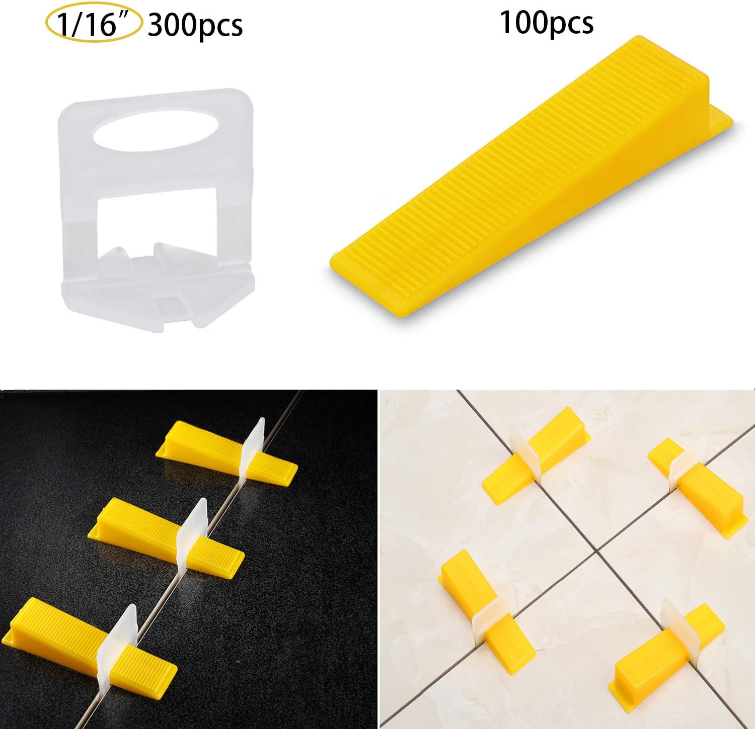

So I'm going in with porcelain in my new addition/rebuild from the fire. I'm wondering if it's going to be more, or less, work to install larger tiles?? The sq ft is going to be big...as in around 1500 sq ft big. Do I do it with 12-15" tile, or 30-36" tiles??

My professional advisor said that large tiles are both easier and harder. Easier because you place fewer of them, harder to get them all level to each other. There are relatively cheap tools to help amateurs like me keep the level. First, two people for sure, one mixing thinset, toting tiles and QC, the other mudding and laying.

Unless you're an experienced tile setter, definitely stick with a smaller format tile. It'll be easier to handle, lay and can easily ensure proper coverage of thinset (ie: no voids) when installing.

When I did my floor, I debated this too. I ultimately went with 12x24. In the end, I'm happy with my choice but I did end up with some lippage in places. A professional who works with this size regularly would have had no lippage. Live and learn I guess. The larger the tile, the more flat your floor needs to be. Also, the larger tiles tend to have a "bow" in them...mine did although it wasn't much. To alleviate the issue, I ran an offset running pattern so the bows didn't all line up row to row. It hasn't bothered me in the least.
Now, for a home/kitchen/bathroom install, I would absolutely look to use a levelling system as shown above. For a garage where 100% thinset coverage is required/desired, I wouldn't. Those systems effectively pull the tiles up to match one another leaving small voids under the tile. I had planned to use one of the systems until I researched them (and got great advice from Dakota).
My space was a lot smaller than yours (about 700SF IIRC). I ultimately put together a pattern that broke up the space into 4 quadrants. This was primarily done in case I got "off" on my lines so the issue didn't translate into the entire floor. I used all the same color tile so the pattern is there but not all that noticeable unless you really look at it.
For 1500SF, get good knee pads/mats/whatever.....and work out a good workflow for back-buttering, setting, cleaning, etc.... And then when your knees are absolutely at the end of their life, you get to grout :).
