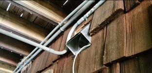

I have both window and portable units but would also vote for through wall for your situation, if it's seeing much use. My 10k btu window unit will hold the room about 75 on a 90 degree day. Much more than 12k and you'll need 240v, think I've seen 110v up to 14k though.
You could also run a portable unit's tube to a 6" through wall vent if you don't want to go for a true through wall. Insulate that pipe though, they get hot! I took a portable unit apart recently and used the blower to vent my garage and cool it down at nights here in the northeast, see screenshots.

My neighbor has his A/C mounted over the door.
