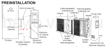

I will be replacing my old forced hot air up-flow furnace shortly with a new furnace that I have waiting in the wings. New furnace will sit on 4" concrete blocks which creates some ductwork adjustments in the return. New plenum is already made.
In reviewing my existing EAC against new units, I see today's models have post-filters as an option. My existing unit at the time made no mention of such. My unit had typical provisions for locating the pre-filters left or right of cells depending on air flow.
The new units mention an ionized surface filter to collect the finer particles that make their way thru the EAC and use the un-used pre-filter position. This style of post filter seems more like a revenue stream than a practical approach for manageable filtration.
Without putting an offset into the return duct, I don't have room to add a new media filter between EAC and furnace. I do however have a 4" wide spacer between furnace and EAC now.
Instead of dealing with more sheet metal work, I was thinking I could use the 4" space between the furnace and EAC to insert a 2" thick MERV 11 or 13 filter. I could support it on both sides with 4 removable rods on either side of the MERV filter. MERV filter replacement access would require removing the EAC cells. Not a problem as I should be cleaning the cells and this would get me moving on it.
I plan to put a delta P sensor on both sides of the EAC and on both sides of the MERV filter so I get an alarm when either is blocked. I will adjust the fan speed during furnace install. (The original media filter that was replaced with the EAC was for 1200 CFM and the current EAC is rated for 1600 - 2000 CFH. This size was chosen to nicely fit the ductwork size. The MERV filter would be 20" x 25" x 2".)
Thoughts? Pros/cons? Should I do the return duct offset instead to install a 4" thick MERV instead?

The max side opening size on a typical residential furnace is 14" tall x 22" wide, and the width may be less on some models.
The fan on residential equipment can't handle the narrow pleated filters, there isn't enough media for lower restriction unless you get the fanfold 6" thick style (NOT the 4" thick style sold at the box stores).
Vertical filter, slammed to the cabinet on one side and slammed to the drop on the other side is pretty much the worst you can do for airflow, but it's easy and no skill is required.

You stated the fans on residential units can't handle dirty filters. In my case, I'm planning to continue running at ~1200CFM through a filter used for 2000 CFM systems. Shouldn't a 4" deep filter with only 60% of the rated air flow through it provide some relief to the concern you mention?
What is the pressure drop across filter media that starts heating/cooling performance problems in your experience?
I see 14 x 22 is clearly dimpled out on the sides of the new furnace.
The ductwork opening into the EAC is very close to 21"h x 22"w as it 90's into the EAC. I previously added turning vanes inside the 90 as well.
I failed to mention, my 4" wide spacer that I previously made, included tapering from the EAC opening dimensions down to 14ish x 22ish on the furnace - or what ever the original hole size is in the furnace.
If I'm following you, it seems like I would need to do the downward return duct offset to provide room for a media housing to accommodate a 4 or 6" deep media filter AND possibly remake the current 4" wide transition section wider to not exceed the 20 degree (1:3) taper. ~18.5h x 23.25w ---> 14h x 22w.
Who makes 6" media/media housing ?
What other methods are used post EAC?

In that picture above, it states to replace the filter when the pressure drop reaches 0.5" WC.
The typical residential fan in a furnace is rated at 0.5" WC TESP, which is Total External Static Pressure. That's EVERYTHING before and after the fan, not just the filter.
Residential furnace fans can't handle the disposable pleated filters. No matter what the 3M marketing says. A 2" filter rack would be uncommon.
What is the TESP of your system now? Then you will know how much headroom is left for a filter (if any). You can look at the furnace fan charts and see the airflow drop as TESP goes up. If the equipment has a variable speed ECM motor, it can usually maintain the set airflow, but motor amperage goes up.
General Aire has a deep media filter, AC22 or AC24.
I do not recommend electronic air cleaners, nor would I recommend any pleated filter, except for a General Aire setup, or an Aprilaire 5000.

Checking back, the age of my existing EAC is up there and I should just replace it or eliminate it altogether while doing the new furnace. New furnace is rated at 0.5"wc.
I will measure the existing return pressure before EAC and also after evap coil for a ductwork system baseline.
The Aprilaire 5000 would do both as a single unit but still has the space concerns and worse yet, blinding over as mentioned causing a high static pressure won't go away.
Whatever my final system is, it will include a magnahelic across the filtering system to provide in my face motivation for maintenance 🙄. Much harder to make excuses.

I measured my existing system’s ESP, fuel consumption, temp rise, and calculated current CFM.
  • ESP =0.85
  • Delta T = 65F
  • Fuel = 103 CFH (maybe 5% high)
  • Air Flow = 1515 CFM
There has always been a noticeable air stream flowing from 1st floor into basement under the basement door when blower running.
I SWAG’d the air flow to each of the supply registers based on floor sq ft the register served. Some were increased to cover hallway, stairway, foyer, etc.
I am even mapping out the actual ductwork, cross-sections, lengths, etc. Hoping to eventually reach total equivalent lengths for each register. Maybe even get to doing heat losses.
My new furnace spec requires two 16 x 25 filter inlets (either side of furnace) or a bottom filter of 20 x 25, which I can’t use.
New furnace has a 0.5” ESP for heating and up to 0.8” during cooling. AC is 3 Ton. So' I'll be at 1200CFM at least.
If I were to add a 2nd 16 x 25 side filter as part of the new furnace installation, I could easily move 3 returns off of the existing trunk that now collectively are ~325 CFM.
This would lower the existing return CFM to ~1200 CFM.
How will this balance out between the 2 returns if I am only providing a new trunk, filter inlet to the furnace and just extending 3 returns runs ~5’ each to the new trunk?
I’m assuming the only way to know the impact for sure is to do it on paper, both “as is” and "proposed" and compare. Any gut feelings on this modification?
I’m trying to keep all of the modification work in the basement. It will not become an entire ductwork system replacement project!

Goodman GMVM971005CN.
I plan to raise the furnace onto 4" block and have already built the plenum taking that height into account. There is an A coil on top of furnace also.
Is my P1 pressure too high or reasonable? This is from the existing set-up.
