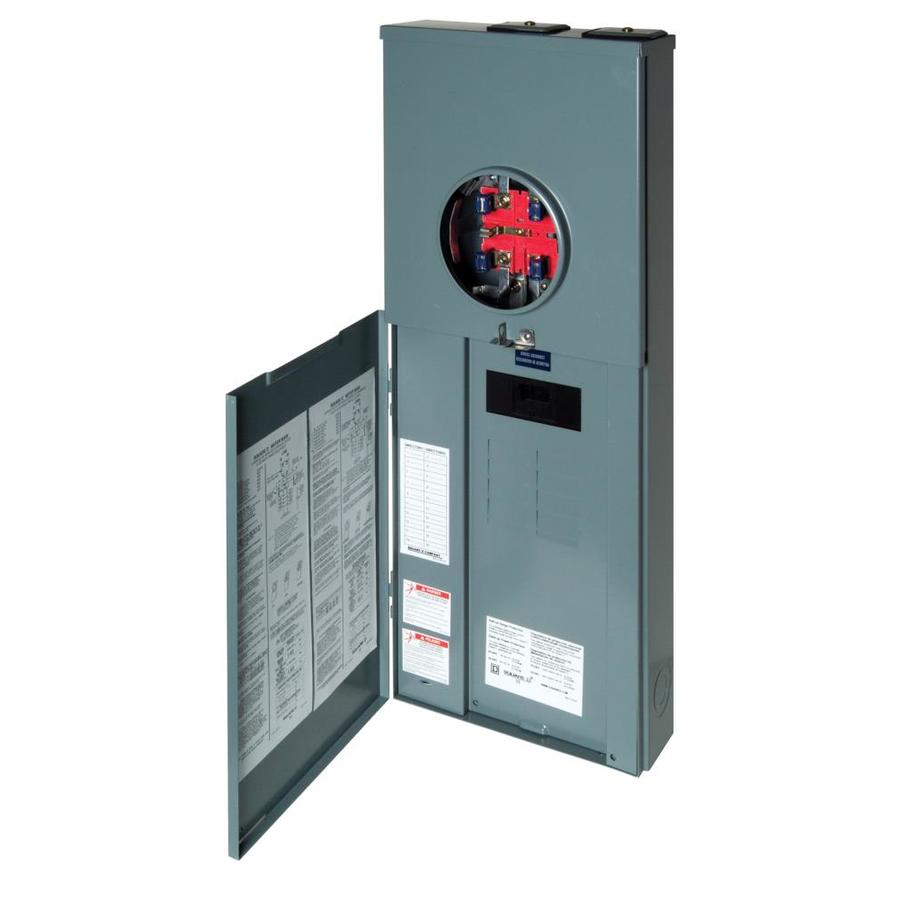

I had a similar issue and I didn't have much luck finding a new 200A meter can with dual lugs... and I'd have concerns about overloading it unless I did a proper load study, and the POCO might not approve it... so I figured it might be better to go with a new Meter/Main panel instead. The SquareD panel that I bought was on my POCO approved list... make sure that you check with them to see what is needed/required for your area.
So my initial intent was to replace my meter socket with a SquareD RC816F200CH Meter/Main panel. I bought mine from Lowes, but it's also available at Home Depot (slightly cheaper) and a few other places.
https://www.lowes.com/pd/Square-D-2...-Main-Breaker-Meter-Combo-Load-Center/3128195
It is an 8 space, 16 circuit capable panel with a set of feed through lugs at the bottom of the row of breakers. It can be fed from the top or the bottom, and has a few different conduit locations on the can.
My intentions were to have the POCO cut power, pull the meter can and swap in this panel, and have the POCO turn it back on. Then I'd run 4 conductors from the new Meter/Main to the panel in my house and make that one a sub-panel. (Split the neutral/grounds and isolate the neutral.) The Meter/Main has a 200A main circuit breaker, so everything downstream is protected. The main breaker in the house panel would now just be acting as a disconnect.
Then when I was ready to feed the power to the shop, I was going to install a Square D Sub-Feed Lug (HOML2225) which basically looks like a big terminal block that takes up 4 breaker positions and has two lugs that you can use to feed power to another panel.
Grab a couple of lugs for the neutral and ground, and run four conductors sized for 200A over to the shop sub-panel.
As it turned out, my POCO liked the plan and sent someone out to take a look at everything just to be sure. (Super nice guy.) So we went over the plan, I showed him my electrical drawings and shop plans, and we went over a few options. Ultimately, we ended up changing my plans for the better... but that's another story for another time.
I don't know what you're working with, what your budget is, etc... but if you had the space to put in a panel like I mentioned above, it might be an option for you. You could install a 100A or a 200A breaker rather than the sub-feed lug to feed the shop if you wanted the additional point as a disconnect. (HOM2100CP or HOM2200BB for example.)
