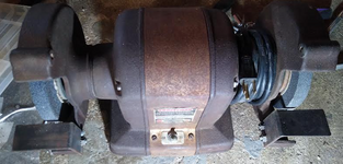

I saw this photo in an estate sale ad. I saw that the left guard was broken off and went to check it out. It's a great parts machine if the price is right.
It was marked $30, but was day 2 of the sale and I snagged it for $20. I did find the broken left-side guard with a good left cover and discovered that the Vimco lamp shade was fubar.
I walked around some more and found the grinder pedestal stand. Ah... it's a no-brainer that the grinder broke when it fell over on the stand. It was very obvious that it was a long time since the grinder was on that stand. The stand came home with me too.
This will likely be a parts machine soon.
More pics after I got them home. It runs good and the rotor/arbor shaft is straight.
