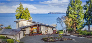

Wow, that’s a nice view to have from your house! Nice work on the metal sculpture too.
We've always tried to buy the view- house can always be changed but the view is what brings the value.
Here's our last house in Washington; it was a 1974 time capsule when we bought it in 2011- did a total interior and exterior remodel, we sold it 8 years later at the height of the market and retired here in AZ.
Having fun with the welding projects. Thanks!
