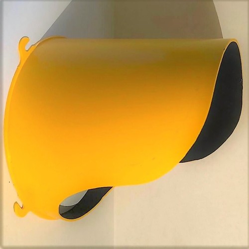

Time for another update; knocked out a couple of small projects this week.
My neighbor gave me an old GE traffic light that was in pretty rough shape. Someone had painted it flat black, the gaskets were literally crumbling, and it was covered in thick ,oily grime. First order of business was to strip the old paint. I started to disassemble it but the brass screws holding the lens retaining clips in place wouldn’t budge, even with penetrating oil and heat. I stripped the head off one and broke a second before I decided to leave that well enough alone.
So, a couple of thick coats of citrus stripper, a brown paper bag that the stripper came home from Ace Hardware in, and I was committed…
Scraped the first layer off with a sharp putty knife; re-applied a second coat and covered it with plastic to work overnight.
P
PugetDude
Mar 13, 2013
22,629
Superstition Mountains, AZ
Took quite a while to get all the paint off the traffic light, using a selection of brass brushes in my M12 drill and die grinders but when I got there I thought it ended up looking pretty good in brushed aluminum. So, it’s going to stay that way for the time being. I have plenty of yellow paint if I change my mind later.
Built the mounting brackets out of 1”, 1-1/4”, and 1-1/2” pipe and. 1” Kee fittings. Used the 1” pipe inside the 1-1/4” to fit the larger diameter to the smaller galvanized Kee elbows- I have a bunch of 1” elbows and tees left over from another project, been trying to use them up whenever I can.
Bought a little controller on Amazon, currently have it running: Red@20 seconds, Yellow@10 seconds, and Green@30 seconds. Had some leftover sheet cork so I shot it with 3M spray adhesive and put it behind the controller; didn’t have enough room for the little plastic standoffs that shipped with the controller.
Got it mounted above the Texaco display cabinets since I had power up there already and I could hide the cord.
I’m calling this one done; I got tired of moving it from one side of the shop to the other over the last year; at least it’s finally functional and off the workbenches.

No visors for you traffic light ? :dunno:
P
PugetDude
Mar 13, 2013
22,629
Not yet. The light has the brass screws (frozen) in place for visors, but they weren’t on the light when I got it. If I find some GE visors I might be tempted to add them. (The light comes down easily, just have to loosen two set screws on the kee fittings. )
