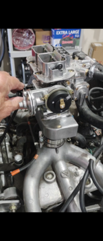

Making progress...got the carb adapter machined, surface finish wasn't that great so I lapped the mounting surface on my surface plate with a piece of 180 grit wet and dry sandpaper and WD40. IMG_20240925_145356741.jpg
It fits the Goldwing engine and the new carburetor perfectly.
Happy with the test fit, will start putting everything back together today. IMG_20240925_145455776.jpg
This carburetor is a knockoff of a Weber 38/38 Two barrel. I chose it because the 38mm barrels are the exact same diameter as what's on the original Goldwing carb.IMG_20240925_145439740_HDR.jpg
This one comes from the highly esteemed Chinese carburetor manufacturer "Thundermingo"🤔
and comes with both manual and electric choke options, @$70 delivered via brown truck from Amazon.
I have 30 days to see if it's going to work, if not I can always send it back. This is more of a proof of concept exercise, I may end up with a genuine Weber($400+, made in Spain) or something different altogether.

Got the carb adapter mounted, since it's on rubber isolators I elected to add a simple brace to help stabilize the new carburetor. The Goldwing carb and air box is tightly surrounded on the bike, in this case it's open on top of the motor. Used a piece of light gauge 1/4 ID" tubing, slid a piece of 1/4 all thread inside it so I had something more substantial to weld the mounting tab to. Welded a 1/4"-28 UNF stud on the other end for a Heim joint to give me some adjustability. Going to need a longer stud on the adapter and a spacer for the Heim, but it looks like it's going to work.IMG_20240926_193848455.jpg

Update:
It runs!
Got everything temped up, crossed my fingers, turned the key... It turned over twice and fired right up!
Idles great, accelerates smoothly, no stumbling or hesitation,
BUT... Has a nasty exhaust backfire if I let off the accelerator abruptly. I can bring it down slowly and reduce the frequency and severity of the backfire but not eliminate it completely. Adjusted the idle jets on the carb, checked for exhaust leaks, plugs, wires, etc. I do have the stock vacuum line going to the ECU. Even tried temping up the Honda airbox to see if that makes a difference. Not really.
Does not backfire through the carb, just the exhaust.
Have a Weber jet kit on order, will try that next. Currently jetted at 45, might just be too lean. let's hope it's that simple.
Ideas, thoughts suggestions, criticisms, complaints, snarky comments welcome.😉
(Weber 38 carb on a Honda 1500 Goldwing Engine in a 32 Ford Roadster isn't something that yields much help on a Google search.)

Scott, popping from the exhaust usually happens when atomized fuel reaches a place in the hot exhaust system where it can mix with air and explode. When the throttle plate closes, vacuum goes way up and a bit more fuel gets sucked out of the carburetor. I believe a long exhaust pipe and muffler can cool things down enough to minimize that popping.

I had that issue with the Cobra when I would back off the throttle. It wound up being a blown exhaust gasket. Replaced them with an all metal compressible gasket and the issue went away.
