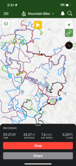

Day 1: Big epic bike ride. I think 24 mi. is the longest MTB ride I have taken. It was a great experience and showed that my endurance is improving. I felt pretty good, even on the climbs.
The Dupont State Forest is a beautiful place. I feel fortunate to live so close to the trails.
