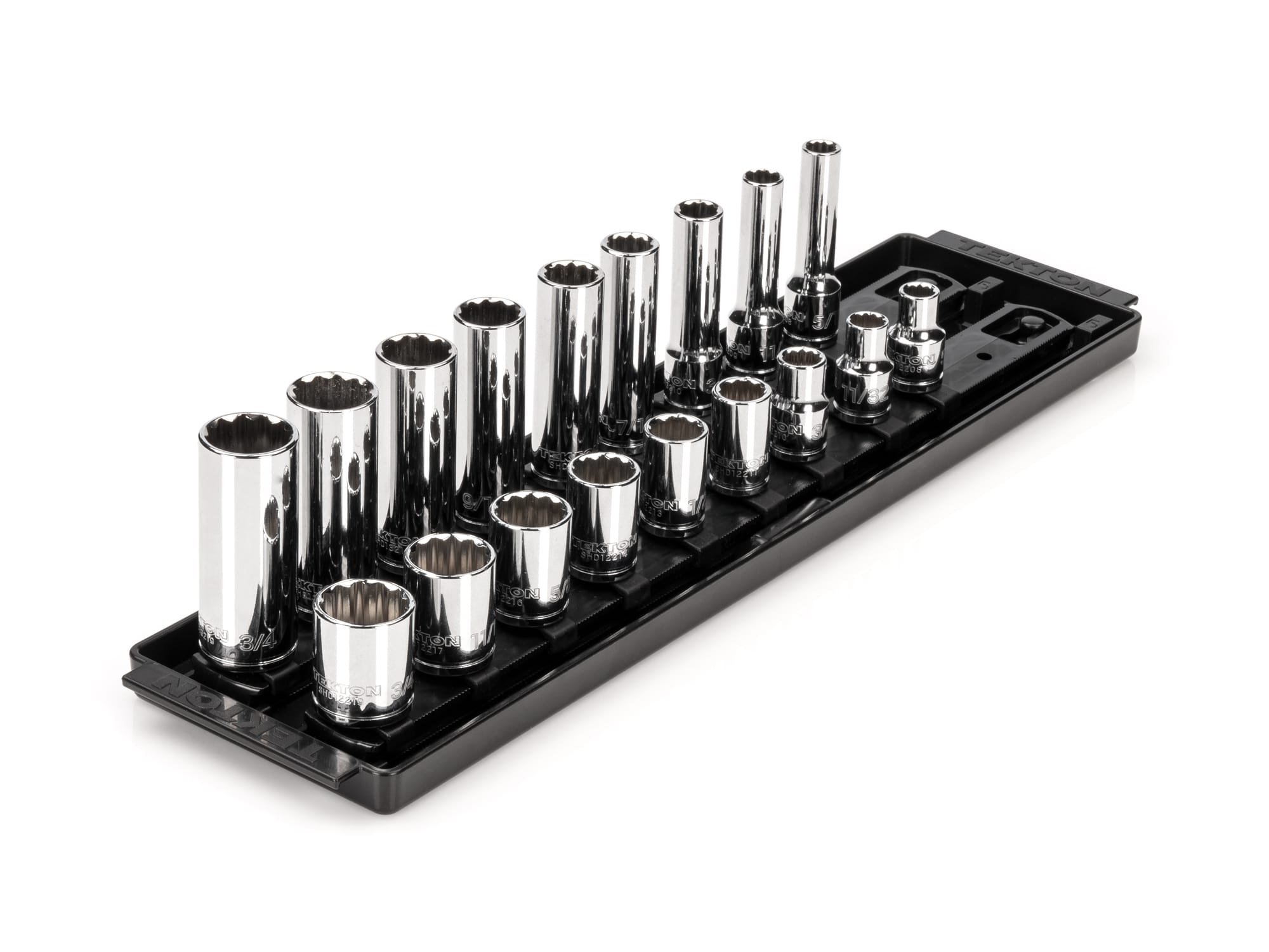

I have Tekton 3/8 drive in both SAE & metric, 6 & 12 pt. I wasn't aware they were supposed to be special?
I have an older set of 1/4 drive deep MM from Tekton in 6pt. I like them they fit the bolts or nuts and they turn them, what does a “special”socket do that these Tektons don’t?
