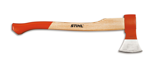

Stihl makes some great forestry axes.
https://www.stihlusa.com/products/hand-tools/axes/woodforestaxe/
