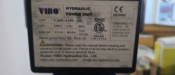

Here is pictures of the plates on the motor.
No way to convert to a 240v motor/wiring.
The outlet/connector for the above adaptor is technically a 24 amp breaker even though it states its a 20. But will the motor need the 30 amp on initial start up (maybe???).
cheap chinese ****
In-rush current on a motor is anywhere from 4x-8x FLA listed on motor nameplate. so it would be way more than 24a... and the trip curve of the breaker in that adapter may not be high enough to allow the inrush current. i highly doubt they designed that adapter for motor loads with in-rush current. surely not a motor that draws more than the receptacle is rated for.

... when i called Atlas they also said max it will draw is 22 amps if ran for over 5 mins.
That is a really STUPID statement ! If that was true and the NEMA 5-15P that it came with was connected to a 15A breaker, that breaker would trip before 5 minutes !

Note the motor can only handle 5 mins of use at FLA per nameplate. This is a cheaped-down motor hiding in plain sight.
I have replaced one on a lift which couldn't handle the constant start/stop jogging and subsequently burned out, in the lightest duty lift application ever seen (probably 500# was being lifted a couple times per year).
I would spend the time to come up with a better 240vac motor and then you will have solved this problem and your electrical problem for a long time.
