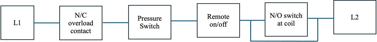

Finally, got power to the compressor today. Been cobbling together pieces since last post. Found a used mag starter on eBay and weather tight enclosure for 5% of market value - may not have been wise.
Turned on the juice and motor running backwards but that gave me a chance to test that switches do what I wanted. One on pressure switch and one at the entrance to the s'hanger. The compressor sits under a shed roof outside opposite the switch. Both worked as expected. Reversed the leads at the motor to change direction and confirmed motor was turning correctly. Feeling pretty good.
Installed the belts, and moved the motor to tighten them. Hit the switch, there was an in-rush of momentum, i.e., the pulleys almost turned, and, then nothing. No go under power. Putzed around for awhile and tried a couple of times to get it to go thinking I would let the heaters cool...nothing. Checked the power in all checked good. Something in that mag starter.
Allen Bradley 512-CCB-6P-900 is the starter tag. Bar code: 0210230939552PNM082.
No smoke sighted anywhere. Yes, the compressor turns freely by hand.
Started working on control plumbing for the compressor.

Picked up a 5hp Lesson at Northern Tool that they wanted to move, bad. 1/3 retail value, ~$230. I pulled in the starter manually and the motor&compressor took off as would be expected. I've fouled the control circuit somehow. I'll try to draw out the circuit and post.
I did check the coil resistance, 40 ohms.
The contractor is a 509 with overloads, I did change the heaters for the FLA of the motor nameplate. They seem to be fine.Unknown-7.jpegUnknown-8.jpegPicture1.jpg

It's a runner. Got the wiring sorted out. Deleted the L2 connection and ran the neutral back to the main panel. Real doofus move on my part with the schematic that comes from watching Youtube and not thinking about what is going on. It did, however reveal the contacts were arcing and an excuse to replace them.
Ran a 30 min break-in. Concentrating on plumbing now. Got to figure out the exterior pipe up the wall and into the s'hanger.
I figure my free compressor pump has cost menorth of $1500. And, I have enjoyed the journey.
