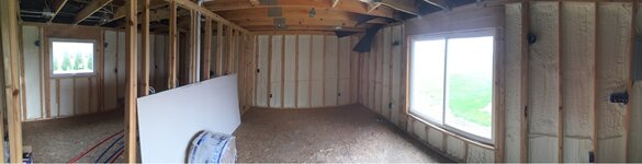

Quick question....anyone....pouring small slab for my wood stove. Do I need to insulate under that? My plan is to put heated floor under the rest of the barn when I lay concrete next year. I plan to insulate that obviously. So, should I vapor barrier and then insulate under my stove too? I am pouring that now to have it functional this winter

I would insulate under it. The more the better to help the heat work mo better. I would use probably 6 - 8 mil plastic sheet, then use 2" of Styrofoam insulation. I bought mine from Menards, they have the kind that has foil on one side and a plastic type coating on the other. Then maybe find some fire type bricks that will reflect the heat away from the stove. My .02 cents worth for free:dunno::dunno:

@bugthug Heavy plastic and 2" foam was what I have and planned to use for the heated floor. So that's what I thought too. Mainly looking for confirmation of ideas. Thanks!

called radient Tech and they advised me that the concrete under my stove does not need foam, only a vapor barrier. so I put down plastic, sand and dumped my concrete. it will get covered when I pour my floor and bringing the total height of the floor another 2-3" but in the meantime I get to memorialize my decision to vote. lol. regardless of your political beliefs, Mine are set in concrete...quite literally.
