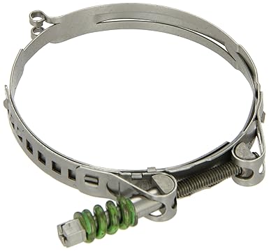

My Oldsmobile has Constant-torque Breeze clamps on the cooling system. Expensive, but like the Oetikers, they don't come loose, they don't leak, and they don't damage the hose nearly as bad as non-shielded worm-gear clamps. They use belleville springs instead of coil springs. Unlike the Oetikers, they've got a generous size range per part number.
Example: https://www.amazon.com/dp/B009SD02VM/?tag=atomicindus08-20
You've highlighted my two favorites. The stepless Oetiker clamps are the best thing since sliced bread. I've found the cheapest source of them is the hardware store, where they're sold for PEX use (and they're my choice for that application too). Unfortunately, the narrow clamp range means that there are gaps between the PEX sized ones that you'll need to have some intermediate sized clamps to fill sometimes.
Stepless Oetiker clamps have solved issues for me with transmission cooler hoses that just would not stop weeping. I have not found anything that seals better, and at the price, I don't mind that they're single use. However, the ones I use would crush a radiator fitting.
I mentioned Breeze clamps above. We had an issue at work with coolant hoses on block heaters leaking from the silicone hoses at the barbs, and replacing all the worm clamps with Breeze clamps solved the issue. Stepless Oetiker clamps would have been fine too, but we wanted something multi-use in this case. Anyway, worm clamps without a smooth interior band and spring loading are totally unacceptable on silicone hoses.
