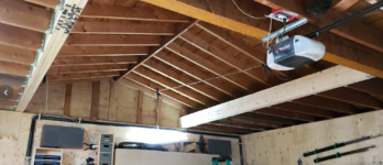

That would work, however your time/materials and labour would be lot less to just do the ridge...and just cut 100% of the ties out. You'd also need an engineer to run the numbers on the stressed skin solution you're proposing as you would likely need some sort of beam (on edge) to cap the cut ties and support the 24 ft of unsupported truss ties projecting 4' into the space. That structure would likely need to be skinned on both sides of the cut ties as well with PL adhesive etc. So a lot of time and $$$ vs the ridge beam and cross supports.
You could achieve the same by doing 16" x 3 LVL on edge, (on both sides of the garage) to reinforce the walls, but you'd need to tie those at both ends. Still less material/cheaper to do the ridge.
Six x 18" LVL at 24" feet long and you're done for about $1300 in materials to do a ridge and cross support beams. If going full length, the rear LVL cross support could be omitted and replaced with a 2x6 (x3) post, so you're only needing four x 18" LVL at 24'.

Hi Denwood, I'm trying to decipher page 8 of (your 2nd link). I see the live load 30/ dead load 15, if I do a 12' raised section, beam support spacing is 12', width of building segment is 24', the beam breadth x beam depth shows 3.5 x 9.5 and 1.5/3. The LVLs are 1.75" thick, so that would be 2 of them. I don't understand where the 3 x 16" you mentioned comes from. If I were going to add a ridge support the full length of the garage (24'), the table says 5.25 x 16 or 3 x 1.75 x 16". I think this is where you got the 3 x 16". The 1.5/3 refers to the bearing area dimension needed at beam support but I'm not quite sure how to interpret it.
Is there a way to estimate the rafter tie support beam requirement from these tables? (which is more like a point load at center span?)

Here is a sketch of a horizontal beam at top plate to resist rafter thrust, around 500 plf. I used a 11.75 LVL but there are other choices.
FYI the thrust calculator is here: http://www.timbertoolbox.com/Calcs/raisedtiethrust.htm And my values in that:
This allows a 12' section of garage fully open to rafters, which was the challenge I believe. In my mind this is simple, safe, and a few hundred dollars versus a few thousand to change to a structural ridge and support it, possibly having to add foundation.

Wow, that is interesting for sure Bill. Do I understand the gussets correctly? The plywood goes the full length of the LVL and ties the wall top plate to the LVL? The 2 x 6 gussets apply at each rafter? (would you nail them through the LVL on bottom?) Also, is the triple tie beam a 2 x 8 or 2 x 10? In addition to being fairly inexpensive, it's all done at the 8' level although I still have to get up to the ridge board and install rafter brackets. For the 672 lb load number, did you use 50 psf or something lower? I come up with 767 lb @ 50 psf.

The horizontal design works too...but if you want to go 24" the beam spec is a lot different. I figure the LVLs to do the ridge would cost about $1000 if you support the rear with a post. I suspect your time vs materials will be quite similar for a ridge vs horizontal beam, particularly if you're only going 12 ft. The horizontal beam would give you ~14" of extra clearance at the peak...perhaps a non issue if you account for roof slope vs car width/contact points. On the 12 ft issue, you should go a minimum of 16' with your opening as even at that length you will have potential issues with hood or rear windshield contact with SUVs on a lift. I would go 20', or 24' if I had the option. If you're only using a small lift (48" ... won't matter as much if you place the lift posts carefully) but if you're lifting anything more than 4 feet, I'd strongly recommend a roof "window" of 20 feet so hood or rear glass contact is not an issue.
The gussets on the horizontal beam would go between the rafters, over your top plate and along the full length of the LVL...so you'll have pieces, tied as well into the 2x6 rafter gussets. You'd need to follow the fastener schedule provided by the engineers. You have critical connections at the triple rafter ties as well. I do like the horizontal beam design and have wondered why it's not used more for these applications...although for my application the ridge works well as I dropped my vertical storage down to 7ft (on an 8 ft wall) which makes a huge difference for storage up there with nothing projecting from the walls.
The ridge will have fewer framing details/gusset/tie in details...where as the horizontal beam will allow you to work at 8ft. I suspect price will be a wash once you purchase plywood etc.
An engineer who could sort the details on dropping a horizontal beam design down the wall a bit, and using a larger LVL would give you a pretty nice surface for extra storage. I'm always looking for room to keep 16" lengths of material under cover.

Thinking about those triple tie beams, I figure something like tensile force in each triple beam at around 3,800 lbs. Cross section of 2 x 8 triple beam is 33.75 sq in, giving tensile stress of about 113 psi. I see allowable tables for common lumber but they only give compressive and bending stress. If I assume the max bending stress in the beam is only due to its own weight, I come up with 272 psi, which I think is ok.

Sorry for delay, in a building code committee meeting all afternoon. I thought plywood gussets between the rafters and 2x6 stubs - which are just to support the lvl from turning. Might do that with a vertical from rafter. Figured plywood was glued and stapled to hold till glue set.
I didn't study the joists to much but thought I showed more than existing number of ties. I initially suggested a steel angle tie - one leg vertical to one tie for supporting the angle and one horizontal for anchoring to the lbs. As to tie size - if no storage load, same as now. Worked before - 60 years I think you said - so good. You or someone suggested storage lofts at the ends - and I wondered what would span 24'. I think making ends storage will be expensive. I feel like I'm alone here in trying to save money, rather than spending your money.
For load I used 45 (15DL+30LL) which came to 672 per joist (1'-4" x11'-6') and divided by 1.33 FC or old. Then I just looked in floor load table 12' spans and total >500 plf total.
Does this help? Remember - I thought of this when I understood you wanted 12' clear, and musings of only 8'. It's not a practical 24' solution imho. And it an option, a very economical one, for what I understood you wanted to do. Nothing wrong with structural ridge but I saw it as triple 18s at ridge and at garage door header, a post at rear of and new foundation under three new point loads. ( I'm never optimistic about 60 year old garage foundations - look at thread on the busted out blocks - no pins, no fill, probably no footings.)
ps: timberlocks through lvl into rafter ties. maybe obvious.

Here's a quick sketch but it seemed to me if I were going this way, I'd go the full 24'. I like the cantilever idea but didn't sketch it that way here. The one thing I'm not sure about is unlike the horizontal beam where it is secured under the existing ties and top surface of it is even with top of wall (to nail/glue the plywood gussets), here, the plywood would be on top of the interrupted rafter ties. I guess if you beefed up the rafter tie connection to the wall with metal brackets and reinforcement gussets and the plywood take the horizontal thrust from there? The other thought I had if going this way was that a beam could be run under the rafters at the same distance from side wall as the columns and extend the columns up to that beam. It would only have a maximum 12' span between the columns and take more of roof load down to foundation. Doing footing under the column bases could easily be added to the slab pour for the car lift pad too (it just moves it up to do first, before garage mods). Just thinking out loud...

Here I modified it to about 14.5' open area. I'm using triple 2 x 8s on the 14.5' span. Maybe should LVL there.

I think trip 2x8 it should be fine - it does a lot more work between column and gable walls which is why I thought it would be 24' long under rafter ties. Not sure if the end 24' rafter ties spanning 24' will support the storage loads.
I'm not sure what is rising vertically above the deck. You shouldn't need anything. The "donut" deck being stiff should be all that's needed. And collar ties are rarely needed. At best the keep rafter pairs tied together, which can be better done with metal straps. Plus they make it hard to air seal ceiling membrane (which I presume is at rafters.)

Still wrestling with the way to go on this. I prefer the ridge beam for the straight forward, simple design but at 10 Lbs per linear foot, a 1 3/4 x 11 7/8 x 16' beam is 160 Lbs. I'm not sure I want to try and wrestle that up to the ridge. I have a block & tackle that would help once I get it on top of the existing rafter ties. I could install an eye hook into the existing ridge board (a 2 x 8) and then use B & T to lift it up near the peak. Maybe add a collar tie near the peak on each end to temporarily hold it until I can get a support under it to the cross tie? Any ideas besides brute (human) force?

It looks like I was in error on the bean weight. At 5.9 Lbs/ft, a 16 .5', 1.75" x 11.875" LVL should weigh in around 100 Lbs. That seems more do-able for 2 guys. Based on a 16' long span on ridge beam and loading of 50 plf, I come up with 9,400 Lbs supported by the ridge and 4,700 Lbs at each end support for it. The loading on the ridge is 9,400 / 16' = 588 plf. It looks like a 2 Ply of the above beam should suffice. I would welcome anyone to check my conclusion here.
On the cross tie support beams for the ridge, I still plan on using columns spaced 12' apart so max unsupported span is 12'. What I'd like to do if it's acceptable is use a single ply spanning the full 24' (LVL 1.75" x 11.875") but then screwing/bolting a 12' LVL of same spec to each side of the 12' span. Assuming a point load of 5,000 Lbs at the center, I get max bending moment of 15,000 Lb-ft and max bending stress of 1,459 psi. The tensile load in the beam is 10,179 Lbs (using the raised rafter tie calculator with H = h) and stress in the single ply portion comes out to 245 psi, which seems acceptable. I'm not sure if this tensile stress is added to the bending stress but assuming it is, that seems to be an acceptable number (1,704 psi). Do these numbers seem reasonable?
The blue lines are rafters, black lines, existing rafter ties and red, the ridge beam and cross tie beams.

Not the lvl structural ridge proponent but I looked at the Versa Lam lvl roof load tables, 115% duration. I concur with ridge but see a single 14 should work.
I didn't check the cross beams and tension.
I suggest a diagram with loads and dimensions and have lumber yard calculate.
Are you leaving the existing ridge board and rafters at ends? I would consider running ridge beam to ends. I know it complicates install but worry about the joints.
Not convinced the non-engineered sistering with 2x10s and raising all rafter ties isn't simpler and less expensive.
