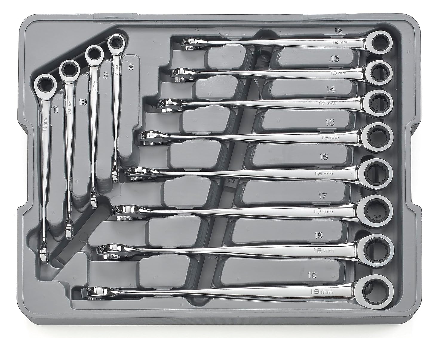

Started to fix my Toyota and I need a set of metric wrenches. Thinking about ratcheting combo wrenches as they are sure convenient when I used them at a friend's. From what I've researched on here, I'd like:
- Reversible Ratcheting mechanism
- Offset wrenches
- 72 teeth
- 12 points
- Trying to keep it around $100 or so.
I found this via another post: www.mobiledistributorsupply.com/23988-12-piece-ringstop-reversible-ratcheting-wrench-set-metric-oem, which has the benefit of some bonus metric sockets which I can certainly use.
Is it a quality set? What's the reputation on OEMTools?
FWIW my socket set is 80's Craftsman "EE" US-made, which I know isn't possible at my price range. But hoping for something that will last me a good while as I don't like buying the same tool more than once.
Thanks for any recommendation?

I have not used OEM ratcheting wrenches myself but have reviews seem mostly good. You can find that set cheaper on Amazon.
GearWrench reversible ratcheting wrenches are generally well liked and are in that same price range. I have used them at my brother's and they worked well but have limited use so other owners may give you better info.

I have the OEM tools metric ratcheting wrench set you linked. They're nice wrenches. Taiwan made like most fine toothed ratcheting wrenches. Satin finish, crisp ratcheting action. They're very similar to Facom wrenches.
One good feature about the OEM capstop design is that it is a simple wire spring. I am not a fan of most capstop designs because, normally it's a flat washer installed on the the top side of the boxed end, that keeps you from using a reverse grip in case you need a different angle on your wrench to avoid something. The OEM design allows you to push past the spring if needed so, you can use the wrench either way. the spring is also replaceable if needed.
In addition to the OEM Tools you linked, you may want to consider Dewalt, Gearwrench, or Sunex (may have spline boxed ends). There are also offerings from parts stores such as Advance or Autozone, that have decent sales from time to time. Although NAPA's carlyle brand may be outside of your budget, they have some nice ratcheting wrenches, as does Proto.

I really like these from Gearwrech since they are offset. Haven't bought them yet but probably will. I have a non-ratcheting set like this from Astro and I love the feel in the hand.

I've got the OEM ones and I'm a fan, I try to avoid putting a ton of load on the ratcheting end but they've been good to me. For a while OEM was also offering the passthrough sockets for a freebie with purchase, they're handy to have as well.
I've dealt with the non-reversible ratcheting wrenches as well, and I cannot emphasize enough that I wouldn't waste the money. They require extra forethought as you can easily enough get a wrench stuck loosening a fastener. I have a set of HF ones, but they mostly sit in a drawer as 99% of the time I'll grab the OEM ones now.
I compared Icon, Tekton, GearWrench, and OEM when looking. I wound up purchasing the OEM offering because of the freebies, and generally positive reviews. If I had more money, I would've bought Tekton due to excellent experiences with their regular wrenches, followed by Icon due to how close HF is to me. But for ~$60 difference, OEM was worth the risk.
I will mention, I've not had an excellent experience dealing with OEM for warranty (I bought a 3/8" metric socket set that had two 9mm and no 10mm), but your experience may differ if you call them. I contacted them via email twice and did not get a response. Tekton's warranty is well-reknowned around here, and might be worth the extra coin if you're willing to spend a bit more.

I'm not a fan of the Gearwrench set I have, but mostly because they are straight, and you can't always get on a nut or bolt straight on. However I've had them for 20 years now and only had one fail. The other issue is that the ratcheting end is fairly large, so you can't get on a nut or bolt if the clearance is tight. However unlike the offset heads, these being non reversible you don't have the little lever to flip to change directions - I guess that's both good and not so good. Mine you have to flip over to change directions....
Lastly, the chrome on them is not the best, it doesn't flake off or anything, it's just not shiny like it was, even if I polish it up with chrome polish it doesn't look great. I'm sure there are better made wrenches out there now than 20-25 years ago when I bought mine......but I would def get some with either a 15* angled head or flex ends

oem ones OP linked pretty good buy with the bonus sockets, nicely mae with soft satin chrome and good usable design.
other option could be ICON as the ratchet wrenches by hi-five are decent .
facom real nice but currently likely twice budget .

Thanks all. I still think the OEM set is at or near the top of my list. Need to look at the DeWalts as well.
One question: If you can only have one set of wrenches for now, would flex head be desirable? Understand that I'd have to give up reversible...
decent slim reversible is best .
Don't overlook the ICON set, I been using them 2 months professionally and they very decent and longer pattern very handy .
flex heads can be useful but I nut using them every day and indeed locking type more usable and decent ones not cheap.
OEM set is decent spec with same stop ring design as Facoms, not a bad deal if like the pass through socket bonus .

Wlai, For me the reversing mech is more valuable than the flex head. Without it I suspect I would paint myself into a corner pretty quick. I don’t use the flex heads much, but when I do, they save a lot of aggravation by sneaking into spots my other wrenches won’t go. So my progression was standard reversible 15 degree ratcheting wrench, then flex head, then stubby, then long pattern zero degree.
