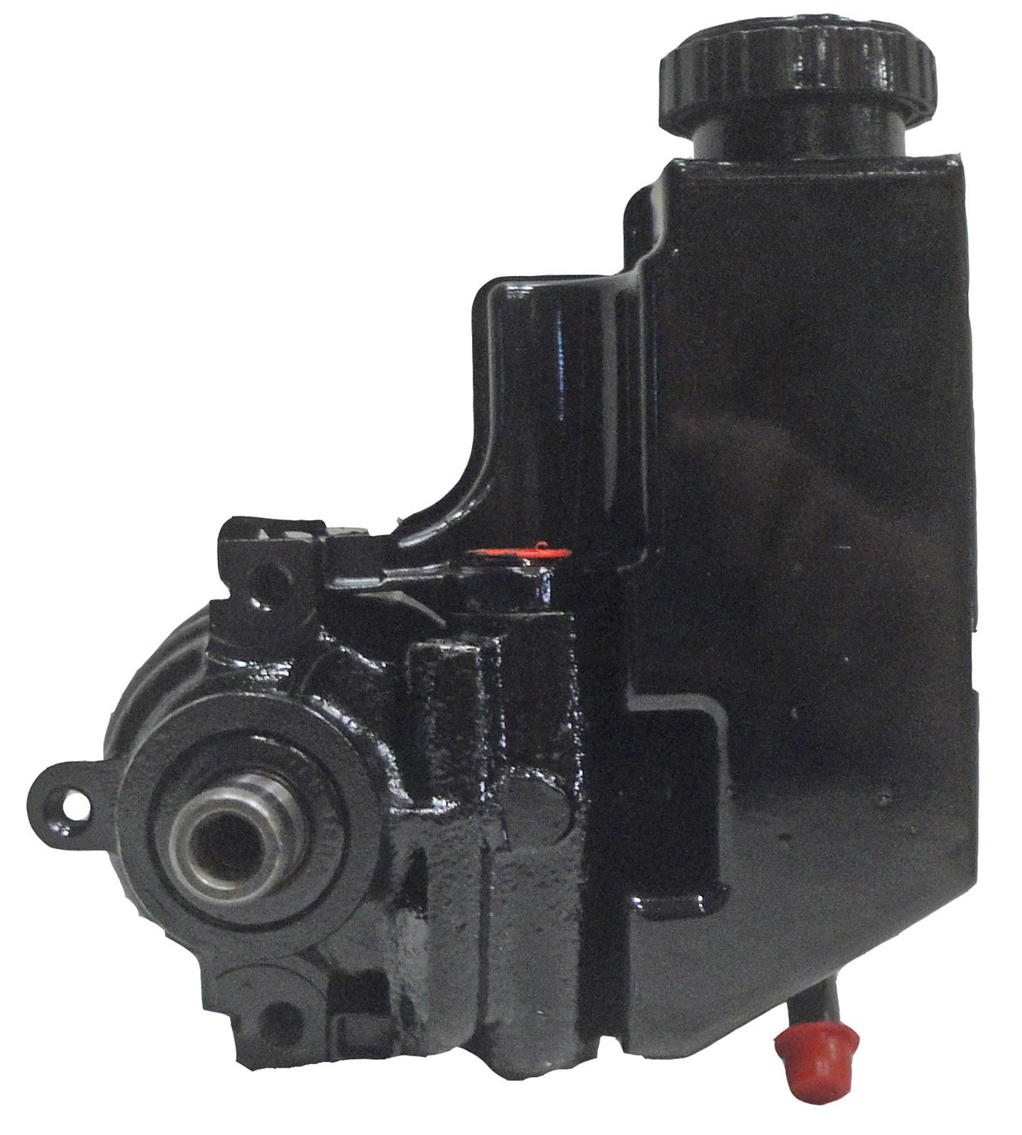

I tried one with a hydraulic assist setup and the size of the resevoir was a problem for the volume and temp of fluid. Not overly surprised, but we were trying to go for easy packaging and light weight. I wouldn't hesitate to run one on the truck with a regular box; should be better than the whining Ford pumps.
Agreed, this is a street machine and has minimal load on the pump.
For pulling a vacuum and filling Justin, I just use my Air Lift coolant system. You may have seen it in use on my thread as I really don't do any cooling system without it. I initially bought it about 30 years or so ago to fill snowmobiles as the cooling heat exchangers were problematic to get the air out, but quickly realized they work great for any cooling system. I especially like that I can pull a vacuum, walk away for a half hour or so to verify there are no leaks. If the vacuum begins to leak off, I know I have a leak somewhere, usually a clamp, then it's just a matter of tweaking one here or there until the leak stops, then pull a vacuum again and verify it's holding. So much nicer and cleaner than having to dump coolant to fix something. This way I know for certain the system's integrity is sound before ever introducing coolant into the equation.
I highly recommend one Justin. You won't regret it.
Ah OK. A dedicated setup. I have an A/C type vac pump but hesitant to use with coolant and walk away. I do have a home made liquid separator I use for brake fluid. Maybe I should make another one out of a bucket only for coolant.
The Bronco upgrade is to a Saginaw pump. That's what I did on mine when I went from the 6:1 box to the 4:1.
Yes I've done several sag swaps. Great for off-roading as you can shim and drill for improved pressure/flow, but not needed in this application. They are old design, large and heavy compared to modern pumps. I want small and light. Then I can move the A/C pump down, package tighter, looks better.

no using V-belts. But yes I did a modified van pump on my 77 bronco.
There is some ******** tech on remote reservoir over on Irate. I see you are a member. Use there is fully hydro, rear steer, serious competition and $$$$.

Someone out there (Wildhorses?) makes a bracket to bolt the Saginaw PS pump used on LS' in the place of the Ford PS pump. Might only be serpentine applications and might not matter. I'm only dimly recalling that it exists and no details. Those pumps are really nice for package size and are a two bolt mount method that is easy to work with and rigid.
Looked at the Irate PS res link, and then watched his first Utoob. I built my own cyclonic PS reservoir without ever finding that thread. I based the design on how well designed dry sump tanks work. It didn't work, but I've learned some and I think that I now know why. Gen I is chronicled in the "Snowball" link in my sig. Gen II is close to being testable, but going to wait until Lee sends the rebuilt steering box back to me and only make a PS fluid mess once. I went remote on Snowball because of the hydro-boost, it just made things easier. And then was sort of forced into it again on the Wagon. Partly because of how Lee PS does things and partly because of the H-B on it, too.

Justin, is there a reason other than packaging you don't go with a pump without a built in reservoir and do a remote mounted reservoir? It seems that would give you the most clearance on your AC compressor and eliminate the fluid sloshing out of the cap.
At the time I wanted to keep the look under the hood mostly stock. A RR setup didn't fit that. Then I went HB and needed a dual return and did the GM style offset res. Then found out that the system cooling (and fluid control) was insufficient for ******** use in the rocks with locked diffs. So I added a big cooler, but I suspect that I may still have issues with aeration and a RR would be next step. Then mod box and add ram assist.
