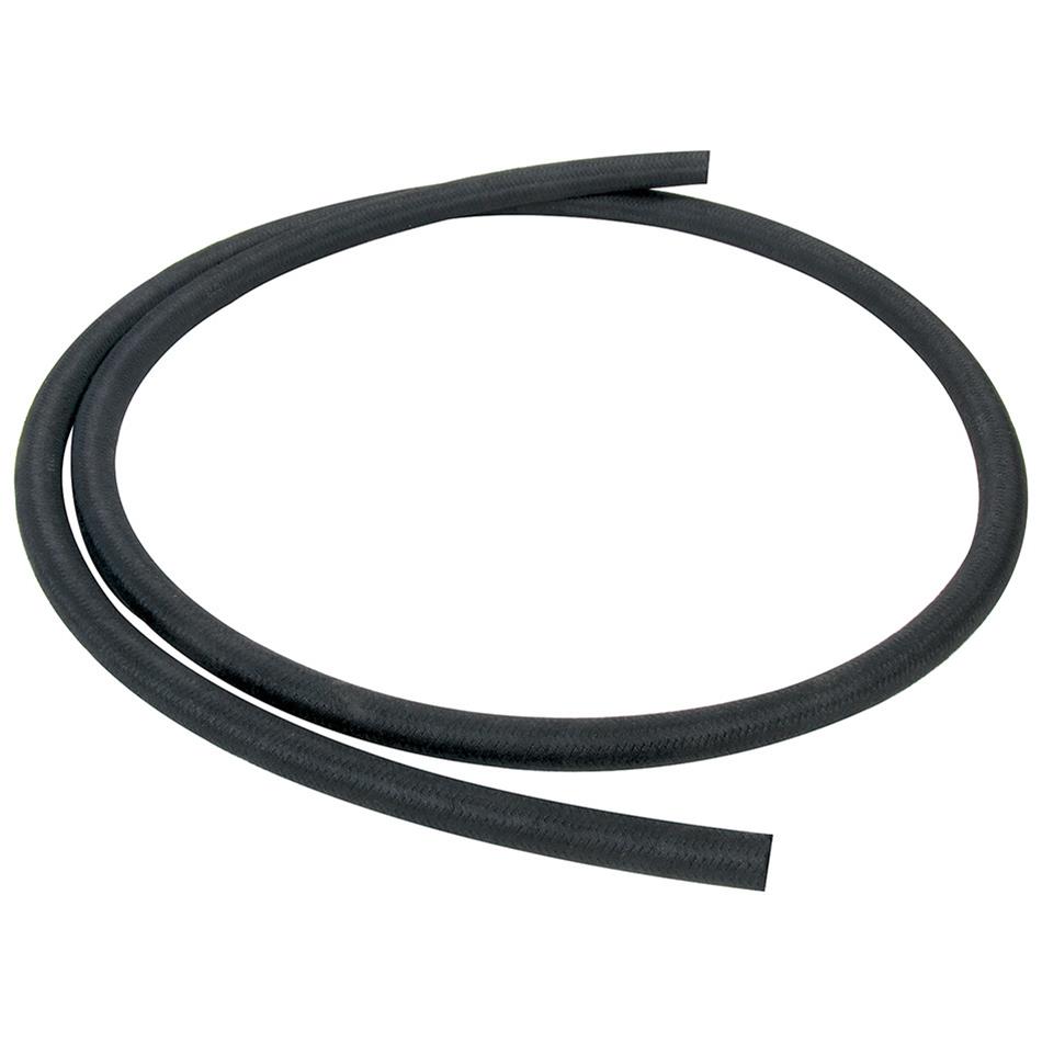

Can you use the PTFE hose and ends from places like Speedway? I’m not sure if they can hold the pressure of the Hydro boost. I was just wondering.
Yes, if the system/hose is rated for the required pressure. Some are, some are not. Some steering system are below 1000 psi and others are over 1700.
The steel hose ends and hose I used are Allstar 'Power steering hose'
For brakes and steering I use steel fittings. This product line also had aluminum fittings.
