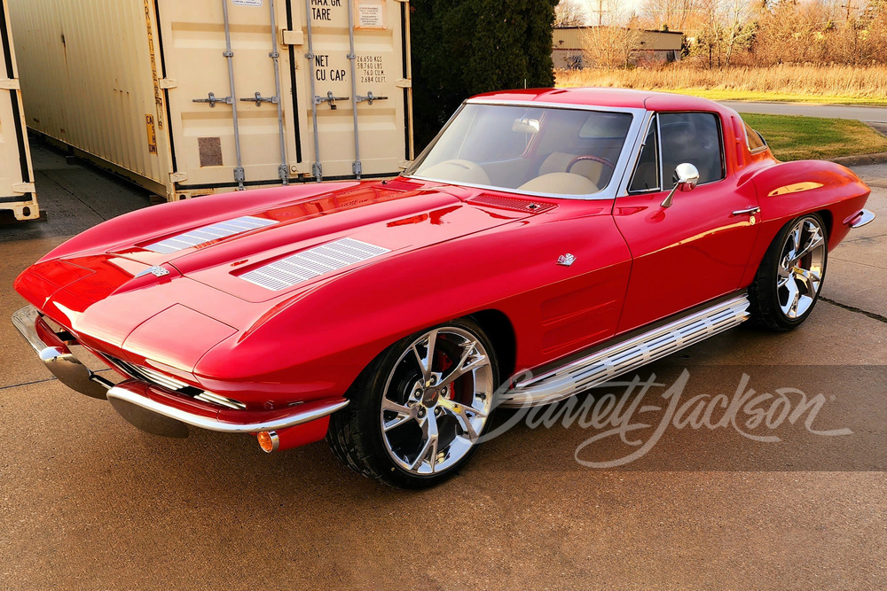

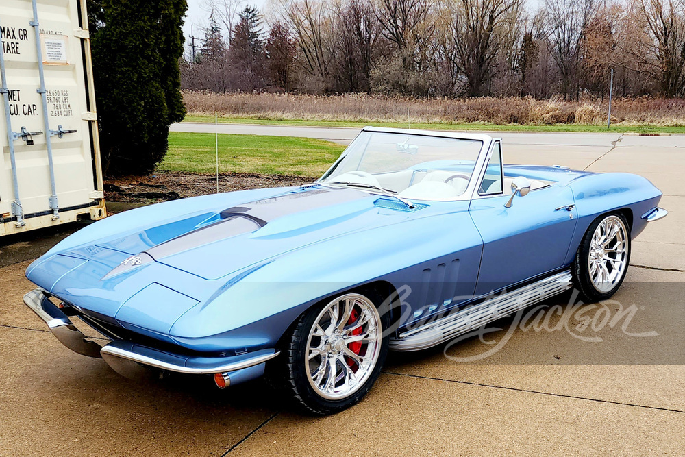

Went to Barret Jackson Saturday to watch some cars sell that a friend brought from Ohio. Two Corvettes again this year, a 63 split, and a 66 vert.
The convertible didn't do so well, bought by the CEO of Rockford Fosgate, which my wife does some audit work for. I showed him some pics of my 72 and he offered to hook me up with whatever I want. So time to swap out the 20 year old giant amp for a class D and some new sub(s).
