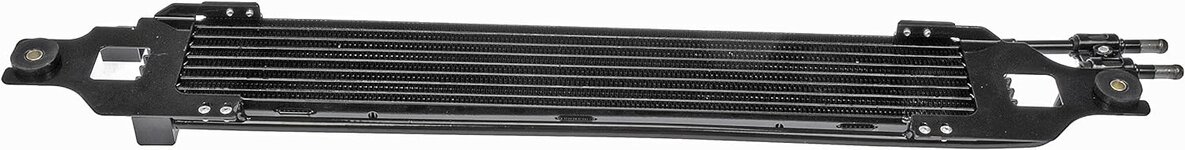

Need a larger power steering fluid cooler, or at least one that mounts in the cooler stack so it has airflow across it. Stumbled across an application specific plate style cooler that was about the right size, with mounting provisions and a hardline to bring both connections to one side.
Dorman 918-287 Automatic Transmission Oil Cooler. From Expedition/Navigator with heavy duty cooling package so should be enough for a steering pump. I though about a fan with temp sensor on the existing cooler but this is more simple. Even when engine is cold, idle in park the fan pulls air through.
Simple brackets to mount to A/C condenser.
Has 10mm barbs. I can get 3/8" TOC hose on but tight. Need to flush the system of the Dex/Merc and refill with Mercon LV same as transmission.

I got the cooler install wrapped up. I added a third fastener in the extra tab to prevent wobbling on the rubber mounts. Local Autozone was out of TOC hose. I had some and made it work by extending the hardline from the box. The long line puts more leverage on the flare nut though, so I should probably redo it. I was able to flush and refill with Merc LV. The hoses run through the same hole as the A/C, so the core support can be removed with out cracking in to the lines.
hit the fasteners with black paint, and it all disappears.
Used Oetiker clamps. 1/2 pex clamps work good for 3/8 hoses.
