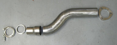

Justin, Mike and Scott, I was into cars about the time I learned to walk. As a teenager all I wanted to do was modify automobiles. When my life changed a bit at 20 I still wanted to work on cars but I had no friends or mentors to help me. When I was fortunate enough to retire at 50 I had the time (and the car) to get serious about working on cars.
I was gifted a rusty set of ****** Headers for my '72 big block Corvette and needed a pipe to connect the headers to the exhaust system. Flex pipe to the rescue...
At first I thought the huge leak was my pipe choice but upon close examination it turned out to be the plate at the four-pipe junction of those rusty Hookers. Jet Hot sent me a set of the same oval port headers that only cost the tip of one of my children's fingers. Now the flex pipe just looks totally out of place so at 63 my birthday present was a HF flux core wire welder ($85) so I boogered some straight exhaust tubing together, ground the welds, filled the holes with more boogers, rinsed and repeated until I gave up. Cut up some stainless exhaust tubing and took them to a welding shop for an estimate and it would be cheaper to buy an Eastwood MIG with 75%Argon/25% CO2 gas and some wire.
Second round with mandrel bent exhaust tubing and slightly less boogered welds and a bit less grinding resulted in two leak-free pipes and was happy enough with the result to sent the two pieces to Jet Hot to be coated.
Connecting the new coated pipes to a rusty old Monza quad pipe exhaust system made no sense. So huge Magnaflow box full of shiny stainless tubing showed up and made me feel much better.
As thrilled as I was with the Magnaflow system, I learned that with stainless wire and 98%Argon/2% CO2 gas makes a MIG welder capable of welding stainless. I put the first set of 2.5" header pipes away and welded up a pair of 3" stainless ones from some mandrel bends and adapters (and v-band clamps).
This starts a long slide into madness, involving cutting up the Magnaflow system, adapting it to a single dual inlet/dual outlet muffler exiting at the center of the rear end under the raised license plate. Dual electric cutouts became part of the system as well -- because...
My work isn't good enough for a Ridicule Award but as I shamble into my 80s it makes me happy. Finishing the car isn't that important to me. It's trying new stuff and happily failing along the way. It really is the journey, not the destination.
