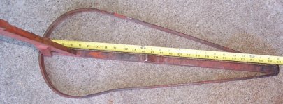

Would you be so kind to add a couple of pictures of your bead breaker? It looks similar to one I have and I need to add a base to it, pictures would help BIG TIME.
Thanks,
Dan
Thanks,
Dan
Well, if I were you, go buy a lottery ticket tonight! He came home directly from school, and his GF has a night class or something so he will be here all night, and helped me get it setup for a couple of pics! :thumbup:
The bottom from a "Plan view"
From the side
And in case you were interested, the top of the post:
If I were building or rebuilding from scratch, I would do the following:
make the top post extendable (sliding tubes and pins...), so wider wheels could be accommodated if needed. The top lever adjustments are somewhat useful, but I will often use that just to get a better "bite" on a reluctant bead/rim.
The "rim hook" on the bottom rail, I'd also make that adjustable, (Sliding U channel over the bottom rail and again a pin...) and make a couple, one taller to go through alloy rims, "Holes" and possibly even cover it with some hose so it does not scratch.
Finally keep a scrap of carpeting around to lay over the base for when you have to lay an alloy rim face down.
From the side
:beer:
Thank YOU soo much! I literally have everything down to the weld mounting the upright to the base. I have seen plenty of bead breakers, but yours is the first that resembles mine. I will likely make a base very similar to yours from scrap I have laying around and weld it all together. The breaker cost me $1, so hopefully that will be all I have in it!
