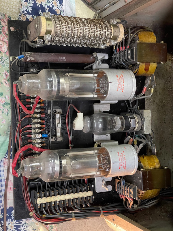

These are the C16J thyristor vacuum tubes I'm referring to (not my pic). I have had them in my hand and installed them. 10ee's can have a tube controlled thyratrons to rectify the AC current to a variable DC voltage to drive the DC motor. Since we don't what year or details, it's something to check for.
PM does indeed have a ton of info on Monarch 10ee's, no doubt but totally agree with the OP's post above, Too many grumpy, harsh, eager to bite as a sport on there, then throw in some politics. That seems to be current priority and then maybe help a fellow member. I've been a member for over 15 years and its no longer an enjoyable site to go to But I've totally digressed and have gone off topic (apologies to OP).

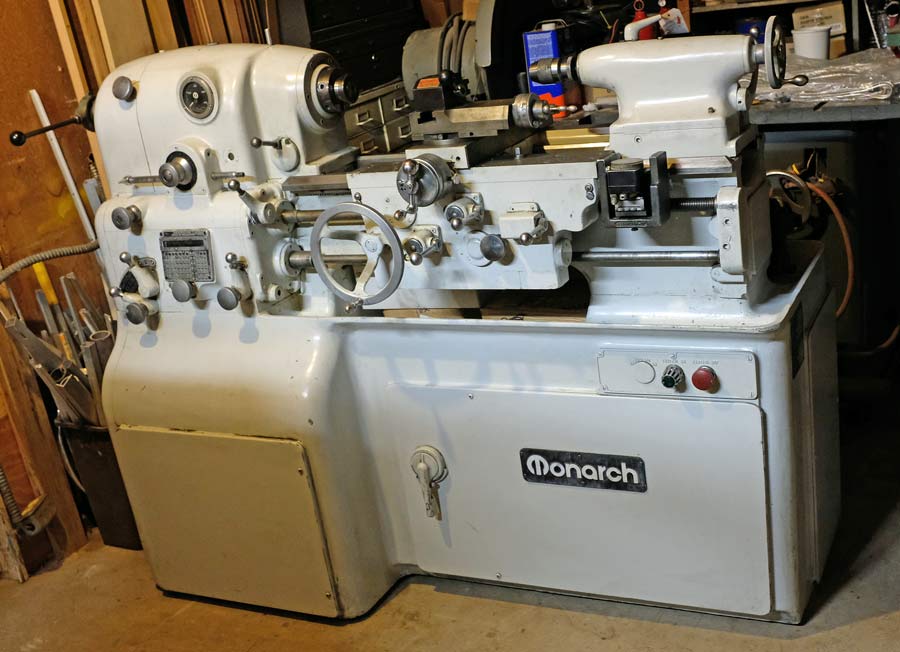

Hey guys, work got the best of me today, but here is what I know about the machine. It is in fact a motor -generator setup. Only major issue is that it won’t spin up to the full 2500rpm, but it’s unclear if that’s actually the case or it’s an issue with the Tach or brushes…it does include all of the factory accessories.
I’m less concerned about the drive unit and more concerned about the condition of the ways / spindle bearings etc. I have researched and am up to the task of converting to a full VFD 7.5hp conversion with the mods needed to keep the back gears intact.
Mostly I’m interested in hearing anything from someone that’s done a full year down / rebuild for things to watch out for upfront. I did that on my Bridgeport and plan on the same for this.

Well I picked it up. Got another 3 hours to drive home but stopped after an hour to check the tarp and tie downs, and surprisingly none have moved.
All original. Everything works and checks out. It’s going to need a good cleaning at a minimum and I’ll probably rewire it with wires that actually have modern insulation.
As a bonus it came with a ton of tooling plus the original Monarch tool cabinets
I’m going to need some leveling castors for it. You guys got any recommendations

Well I made it home with the lathe and my tarp job, while it looks sketchy did a great job of keeping it dry despite driving through one of Seattle’s classic Juneuary Monsoons .
Here is an image of its future home. It’s going to go on the left just past the bikes. After mostly lurking on here for years, I’m starting to think I should start a thread on my garage as it’s pretty heavily action sport based and is a bit different than the average garage on here.
Here is a bit of the tooling it came with. (The mitutoyo stuff wasn’t part of it. I brought it down with me to inspect the lathe)
All for less than what a South Bend 9 in beater shape with no tooling typically goes for around here. The collet set is a full set of Hardinge 2J collets. All the way down to 1/32”. What the hell would you possibly turn that’s that small?
I am already cursing it a bit thou as I dropped one of the 20lb cast iron access panels on my foot, when I slipped unloading the slick wet wooden deck of the trailer. Small price to pay I guess. However the good news is so far my wife hasn’t given me the toung lashing for buying it that I expected on returning home, but I have a feeling that’s coming. I did show her the CL listing for one a guy is selling locally that has been cleaned up for $10.5K, so hopefully that helps my cause with her.
Next step is figure out a leveling foot / castor setup. Ideally I’ll install both. With leveling feet retracted, let it move on castors, then extend leveling feet to lift it off castors snd level. I need to get that sorted as I want to install them when I rent a forklift to unload. I’ll temporarily lower it on 4x6’s to safely install the feet / castors. While I’m doing that I’m going to start tossing the tooling into my ultrasonic cleaner to start cleaning it.
